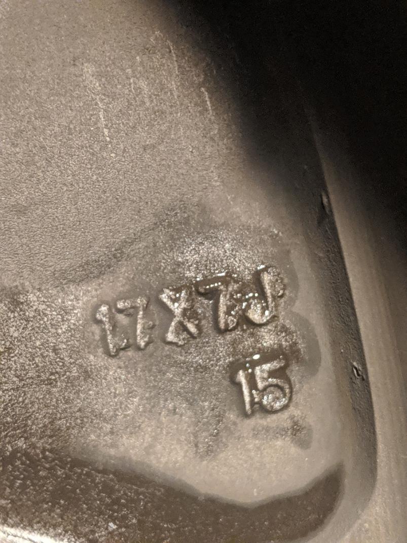

They are not the same width. If I remember correctly, the SR5 wheels are stamped 17x7.5

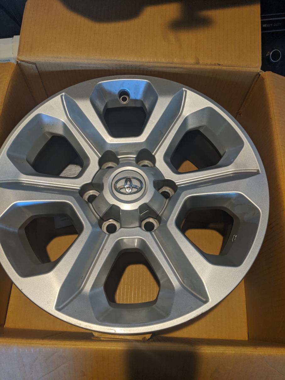

Here is a photo of the boxes when I picked up my TRD PRo wheels from a Toyota Dealership. You can see '17x7' clearly on top of the boxes.

idk man looks like you used a sharpie lol

my 2018 SR5 are 7" wide, I measured them.
the factory SR5 and the TRD PRO wheels are both 17x7" dimension whereas the SR5 wheel have positive 15mm offset and TRD PRO have negative 4 offset. The Trail Edition/TRD Offroad is 17x7.5" dimension
TRD PRO and SR5 wheel have same dimension. Both 17x7" however they have slight different offset. SR5 is positive 15mm offset and TRD PRO is negative 4mm offset I believe.
me too. And I was able to sold my old SR5 wheel. The TRD PRO have more negative offset so it sticks out towards the street more than the SR5 wheel.
SR5 wheel is positive 15mm offset
