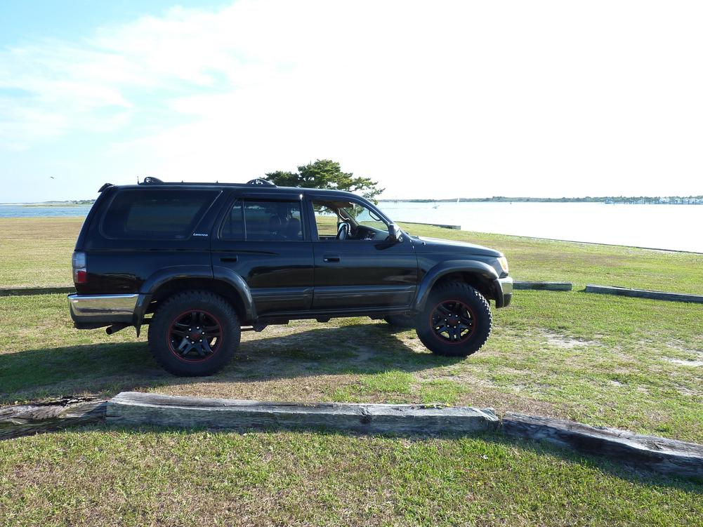

welcome Jason. i act have 265/70/17 On A/T's and no rub, unless i wheeling and fall into some hole lol you should be fine, but mine is Limited and 4x4 and i don't know if you have different clearance.
