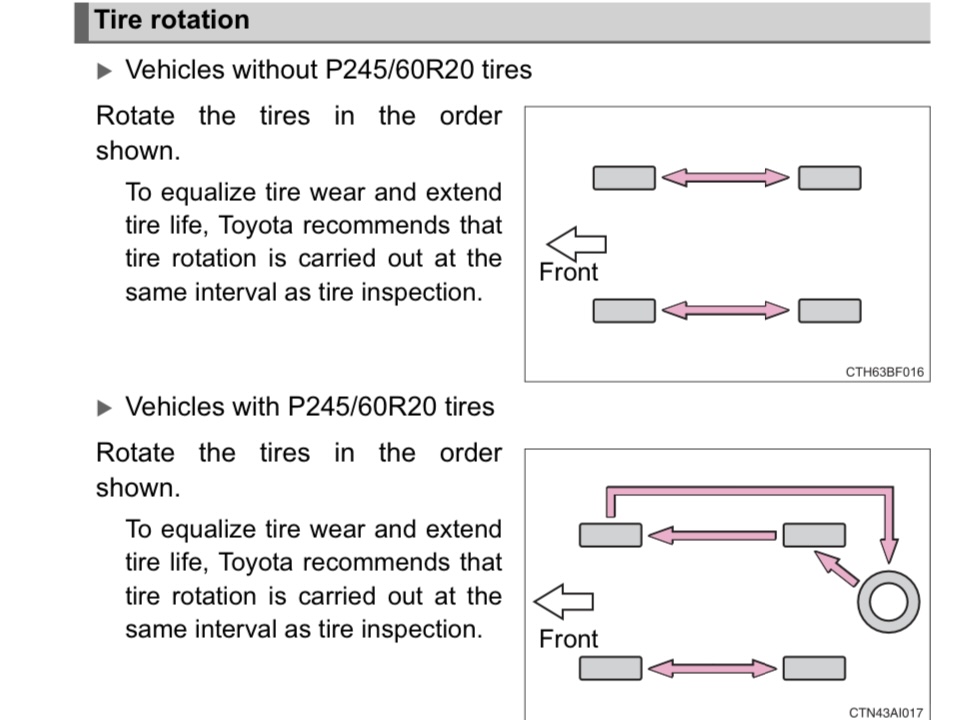

From the user manual;
The question is I have 20 tires but I dont want to use the spare. So do I just do front to back?
As [MENTION=333160]ahtoxa11[/MENTION] said, front to back. I believe that 20 inch spare rotation was shown because the Limited spare is a matching alloy wheel. The other trims have steel spares.

i do 5 tire rotation and replaced my steel rim with the alloy rim and new tpms. it's a 2020 sr5
here's how i do it.
spare go to rear passenger
rear passenger goes to the passenger front
passenger front goes to rear driver
rear driver goes to the front driver
front driver becomes the spare.
