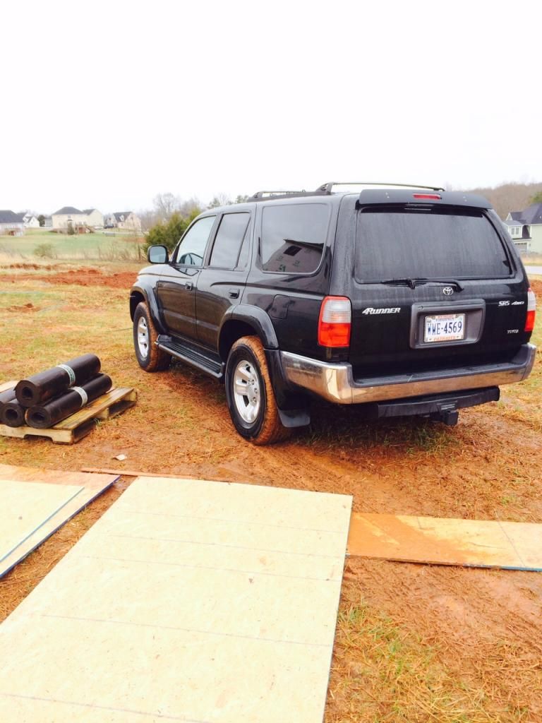

231mm dont need really any modification either. Cant see your rims but most 2000+ 4runners rims clear the 231 caliper. You would need to post pictures to verify your rims. The heat shield on the brake needs cut very little for either caliper and is done very easy with tin snips or dremel. I recommend going 231mm, its well worth the upgrade. Toyota went to the 231mm because the 199 was small and caused vibration and warped rotors.
runner.jpeg~original
Toyota 16's... what year Tundra parts am I searching for?
