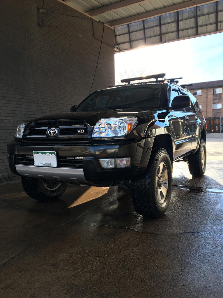

Hey, so I'm looking to buy
18" rims : fuel assault 18x9
And I also want to get: nitto trail grapplers AS BIG AS I CAN GET, that will fit on my 4th Gen 4Runner
Right now, I have stock lift and suspension and I have a 3" spacer in the front.
So my question is, what is the biggest tire size I can fit on my 2008 v8 4x4 sport 4Runner using the 18x9 rims I wanted. In the future I also am planning on getting a lift kit of a good 2-3" front and back.
Please help! I know there are many threads on this topic, but after years of pondering which rims and tires I want, I just need help sizing now!
Please share your knowledge and reply!

Here is my 4Runner

How important is turning ability? You can definitely fit 33s, though you'll have a bit of rubbing. You can squeeze in 35s with a lot of rubbing as long as you don't need to make any u-turns.
"As big as you can fit" depends on what mods you are willing to do, or how much you want to trim inside your fenders or cut your body mount. Even with 33's, which are considered easy to fit by most, require trimming and a body mount chop.
