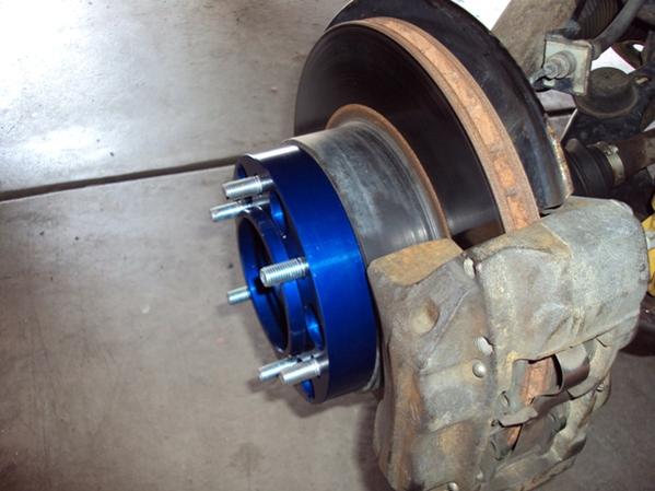

I run the Spidertrax 1.5's and they work great. Got em at 4WheelParts.
I know there are other reputable spacer companies out there, so do your research and don't skimp on price on this purchase if you go this route. I've seen some really nasty pics of spacer failures. I went Spidertrax because of their solid rep.
Oh, and I decided to use spacers for two reasons: 1. I will eventually (very soon) do the Tundra brake mod and don't want issues with caliper clearance, and 2. I was rubbing after lift and tires. HOWEVER, adding spacers took care of the rubbing in one spot and moved it to another. So, I still had to whip out the grinder. But, all good and happy now. It takes extreme circumstances to rub now (full turn, big bump, ect). Love my spacers and the look/function they provide. Yes, you can see these are hub-centric...and pretty blue. Too bad you can't see them after the tires are mounted. Just my .02.
