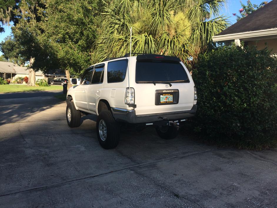

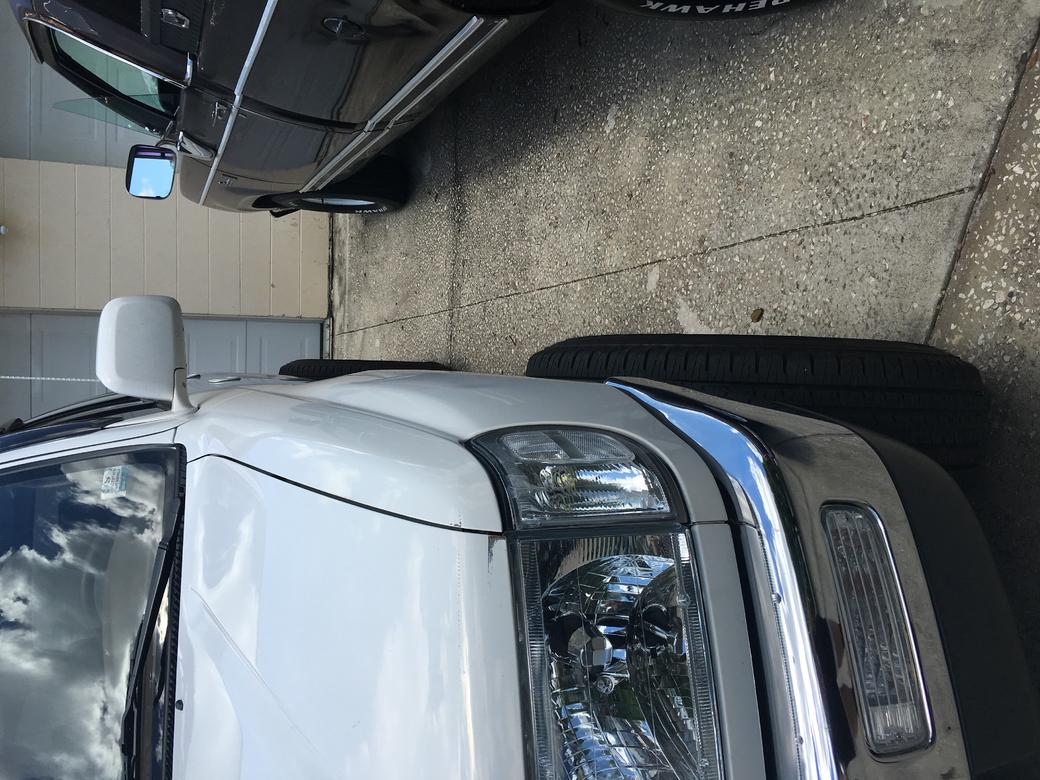

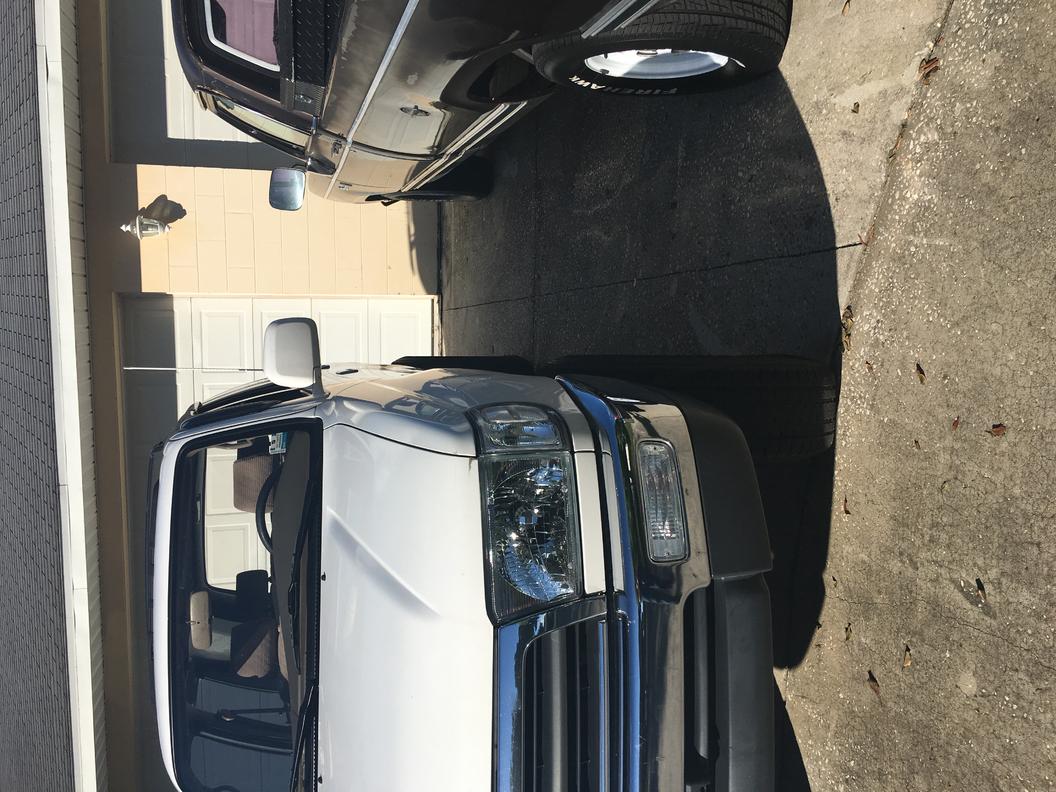

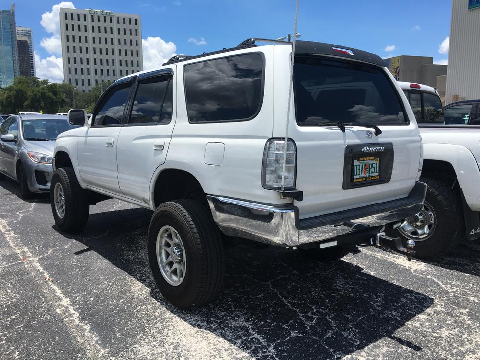

Hope this helps you here my 98 with:
Eibach/Lc 8 Wrap Lift
265 75 16 on 16x8 with 0 offset (same as 4.5" backspace)
Spidertrax 1.25" wheel spacers
1st and 3rd photos are before spacers
2nd and 4th photos are after
To me it looks way better with the spacers than without and I have no rubbing before or after the spacers
Bigger tires will come once I figure out if I wanna keep these wheels and powder coat them white or get a set of 7 spoke trail wheels
With my wheels before the lift I could not have fit them with the spacers as I would already just kiss the pinch weld at full lock and hitting a bump without them
