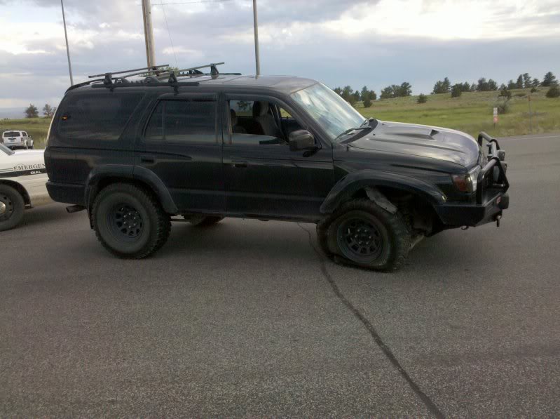

thats the result of a broken ball joint?!!?
thats not the worst...
Rics 4runner got totalled...
Snowrunners brake line tore if I remember right.
