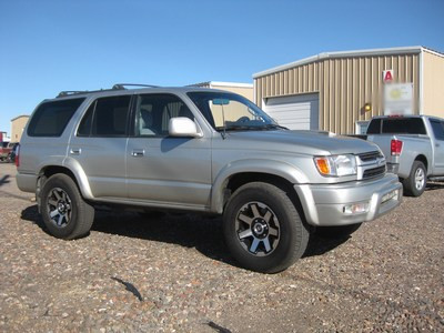

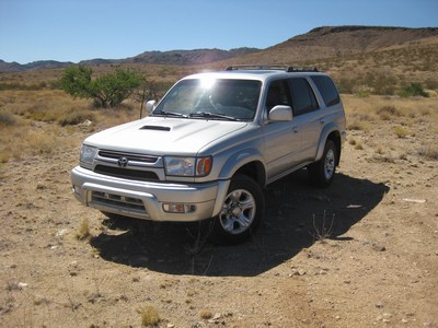

A lot of good info in this thread. I can tell you my personal experience going from the 225/65/16 (someone had installed) on my 01 T4R to 17" 2018 265/70/17 T4R off road wheels. The speedo read 89 mph when I was doing 80. I'm in the Southwest; we do that here. When I found a set of 2018 4Runner wheels with original tires on it the speedo matched up with the GPS. Gas mileage is the same or better now. No noticeable difference in power or pep even though the tires/wheels are significantly heavier now.
Original:
With 2018 T4R wheels:
In my opinion this was a major upgrade in ride, looks, and correcting the speedo. It's also amazing how much better these look without the sideboards.
