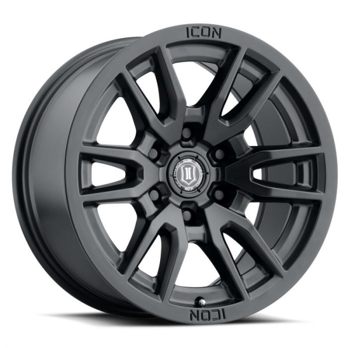

Thus the icon wheel. One of the few I found without simulated bead lock.
But then you got that god forsaken ugly Icon Stamped on the outer rim.
