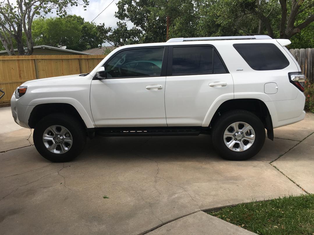

Also just installed the T13's and 2883 ome coils and front and rear 5100's. I also added the ome 10mm trim packer on the driver side only rear T13 coil and also added ome top plate trim packers on both front 5100's. I ended up with 2.5" lift in front and 1.5" rear after settling.... ( no third row seating-full fuel). Only have about 1/8" difference between driver and passenger sides height. Without the rear trim packer on the drivers side coil I probably would of had an approx 5/8" lower driver side. That rear trim packer also helps keep the fronts equal in height. My center hub to fender measurements....fronts 22.5" rears 23.5".
Without the front ome trim packers, your 2883 coils are going to give you about 1.75-2" after settling. I could of just gone with 2884 coils without trim packers and ended up with same end results (2.5" lift). With the 2883 coils and top plate trim packers, I can always take out the trim packers if I decide I don't want a full 2.5".
I didn't want to later regret not being able to get my alignment numbers where I wanted so I also installed SPC uca's when I installed everything...alignment ended up 4.2 caster and 0 camber. (Still have a lot of adjustment left on my LCA cams so you may be able to tweek 2.5*+ caster out of stock uca's with the 2883 coils )......Mine drives great with where my alignment is now.
I'm extremely happy with this set up. Tad stiffer than stock with less body roll and no nose dive when braking. Still has a very comfortable ride for a daily driver! Hopefully wheels and tires coming soon .
