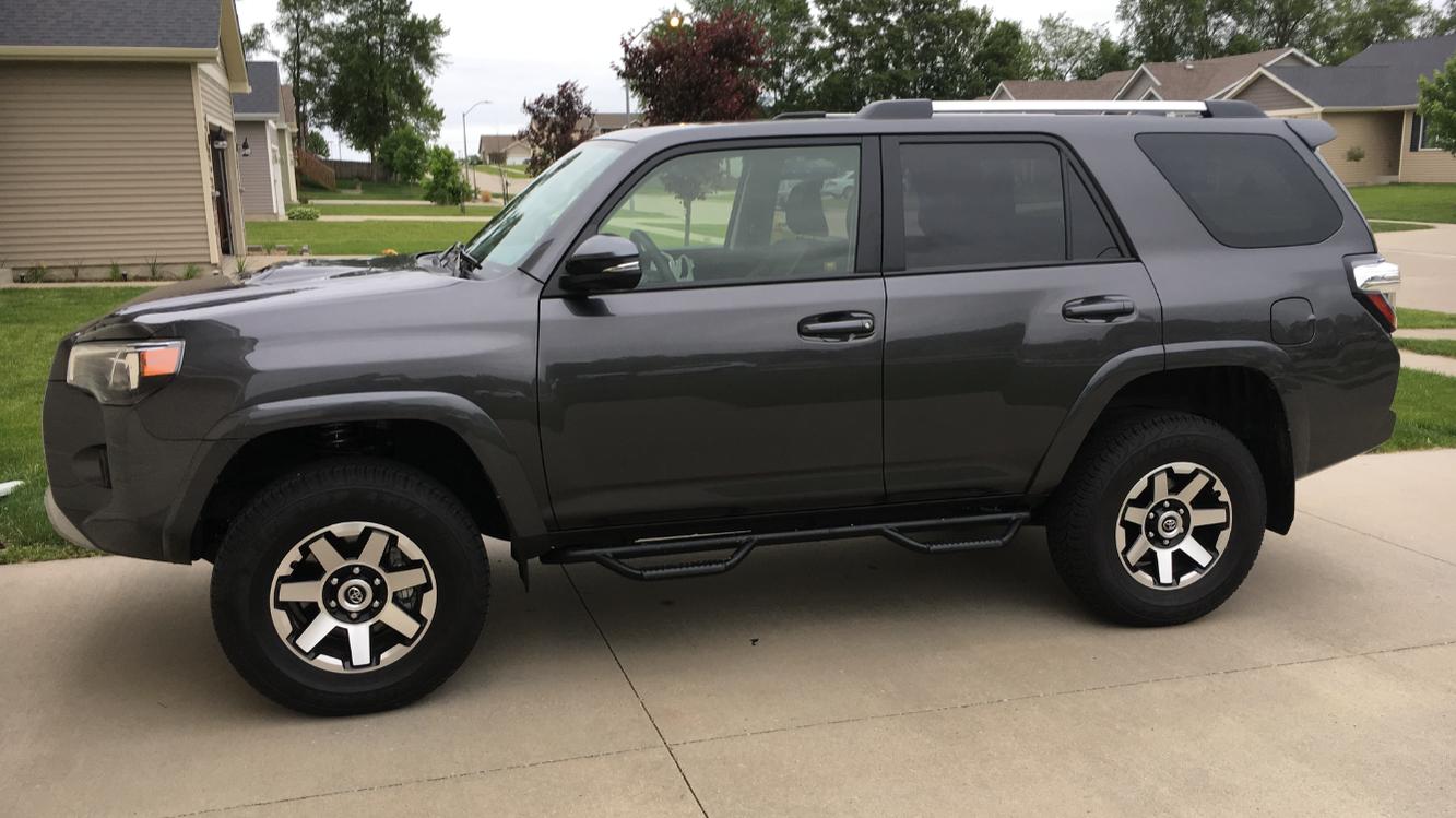

I am running T1 and T13 coils with 5100s and 10mm OME trim on driver side. Very happy with ride quality and height. I think this is the perfect 2.5/1.5" lift option for the price.

looks killer man. bottom setting on those 5100's? i just spent time on wheelers thanks to your pics, opting for the 6112's brings total price to about 290 more then the 5100's with the T1 coils. any reason you stuck with the 5100's?
Glad to hear! Wheelers are good people and great customer service.

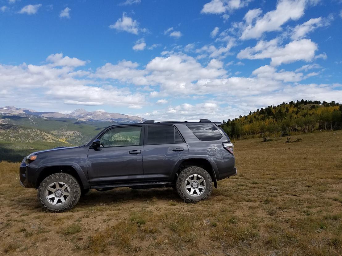

I have 5100s on my '16 Tacoma and liked them. I've had the 4R for a month and I honestly just ordered what I knew would work well in order to get it ready for the ATR event coming up on Labor Day weekend. Last weekend ( results not pictured ) I bumped the T1's to the second notch ( had the truck aligned again ) and threw in a rear cornfed spacer on the T13's to get an idea of what it would look like. Needs UCA's since my caster is only 2.5 deg and my camber is at the end of acceptable spec. I'll be ordering UCA's soon. I like the ride better with the T1's on the second notch and the 2.5" in the rear is the way to go. I think the T12's are 2.5" so I will probably upgrade to those and maybe the 5160's in the rear.
Not the most economical route but it works. I probably should have gone 6112 to start with.

Sorry for any confusion. Yes my T1's are at the second notch (.85) - Yes needs UCA's at this setting IMO.
Alignment was fine with T1 on the 5100's at 0 with stock UCA. That is the setting in the picture.
I installed 10mm spacer on driver side due to the driver side being slightly lower.
