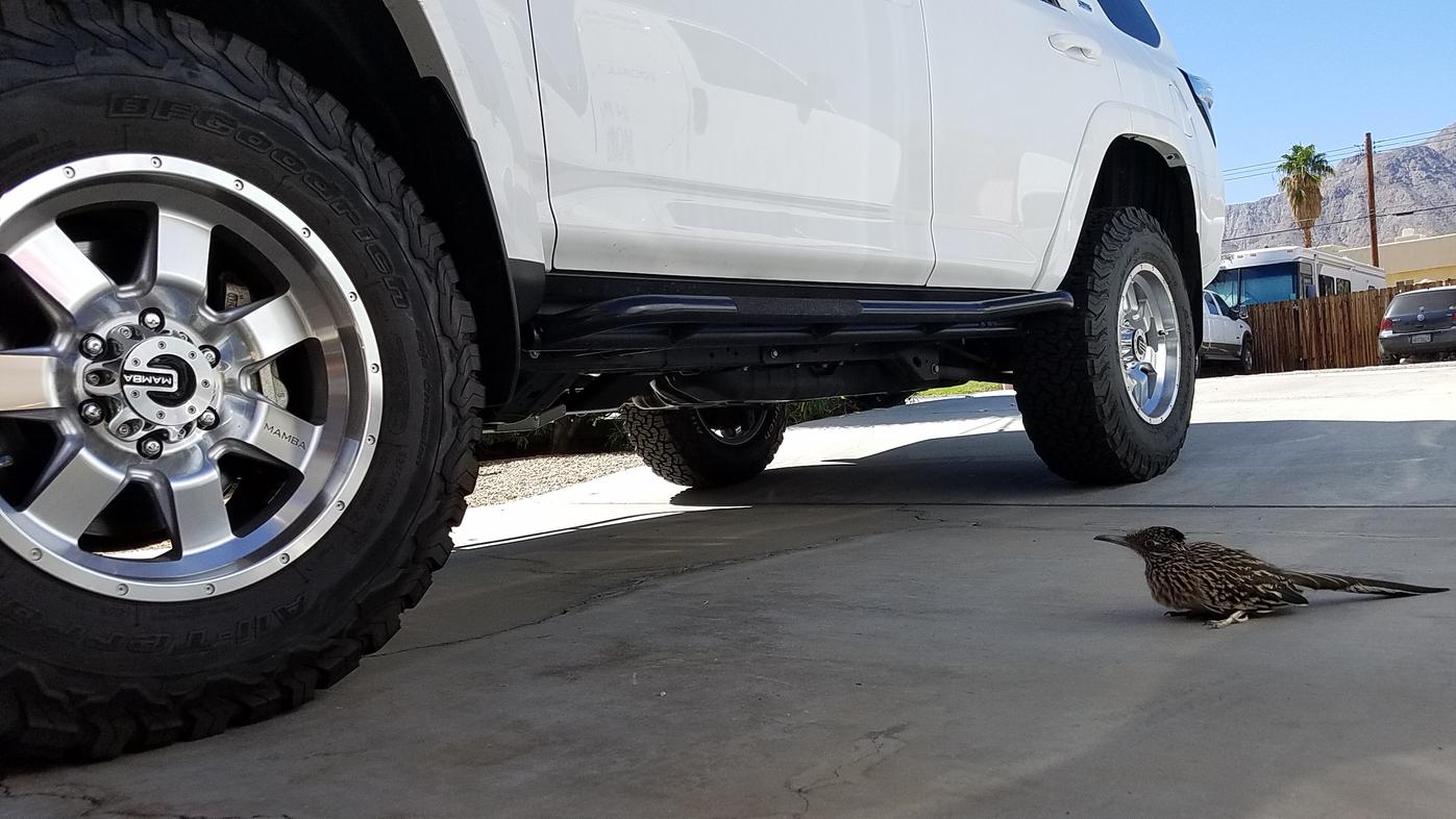

[MENTION=164651]YellowRaven[/MENTION] I have 17x9 -12 Black Rhino Mojave with 285/70 BFG KO2’s. I really like the look of them. Let me know if you want different angle pictures. Happy Hunting! No alignment need if just changing wheels and tires, but I always recommend having it checked a few times a year.

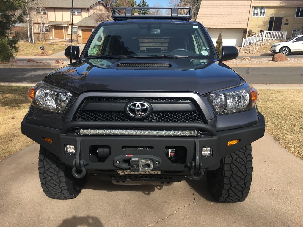

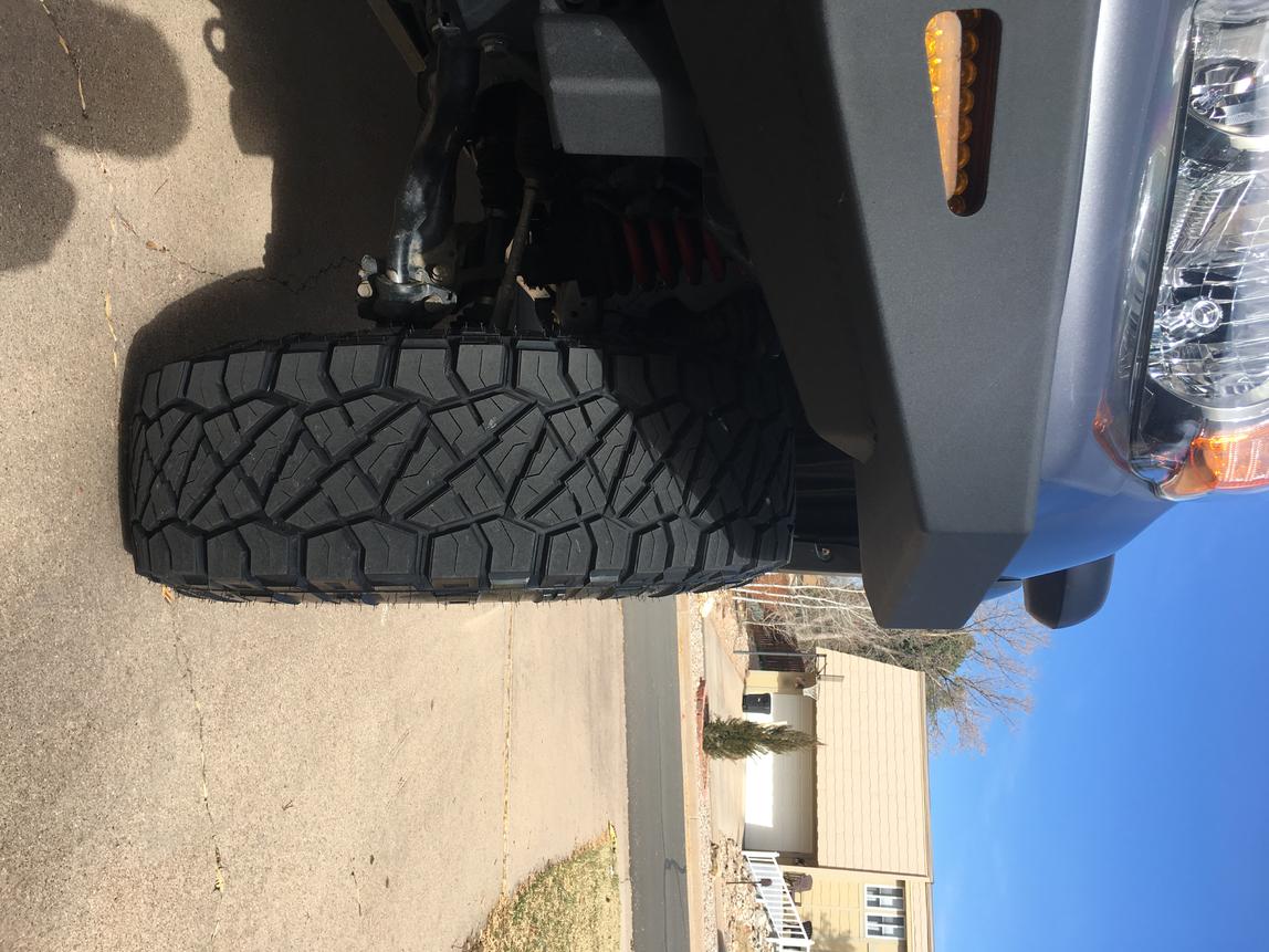

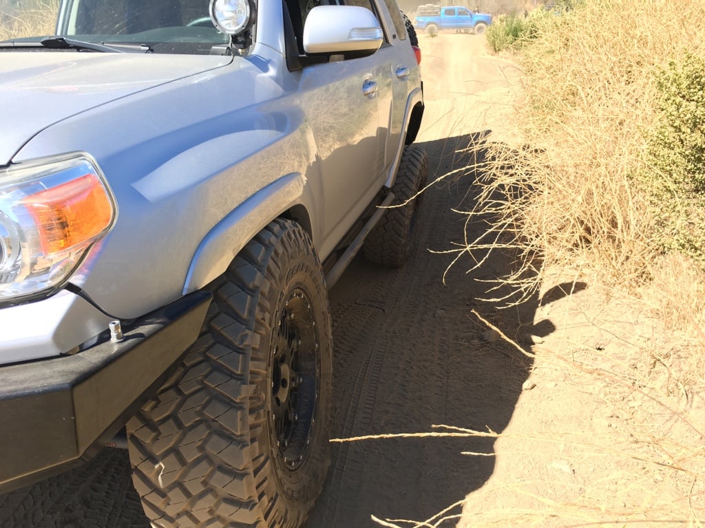

I was super lucky with my set up: 285/70s on 17x8.5 (-6 offset). The tire literally kisses the body mount when turning. I had to do lots of plastic trimming, but no need of BMC at all. I have an OME 3” lift. Do the math with the wheels and tires you want to use... I don’t think you can go with any set up that puts the wheels further outwards than mine without materially rubbing the body mount. If plan to use 9” wheels, make sure the offset is less aggressive (i.e. more positive) than mine. My tires are Nitto Ridge Grapplers btw.

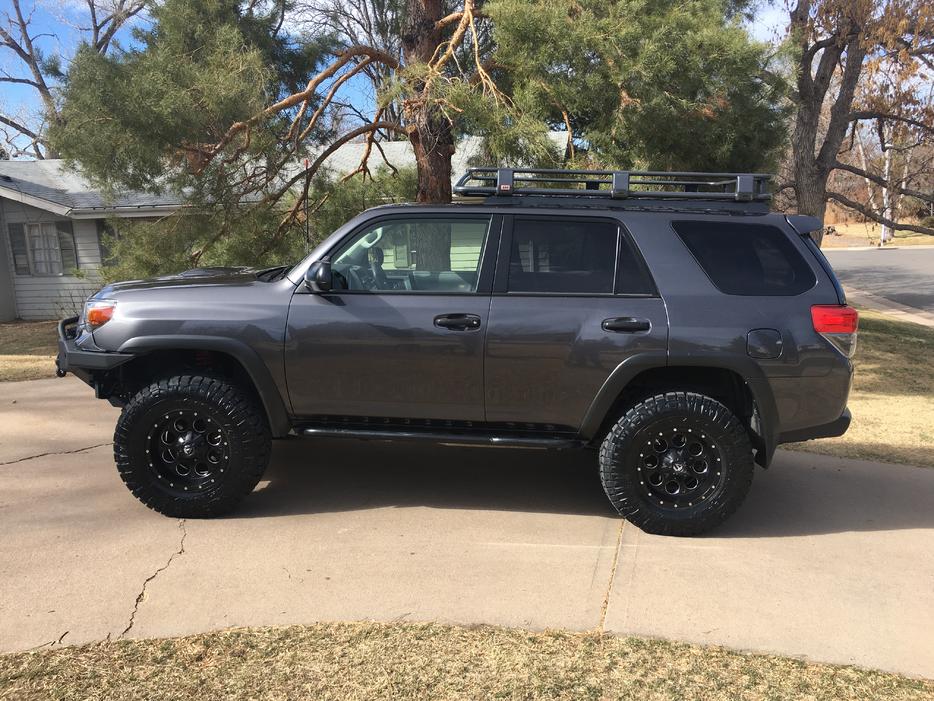

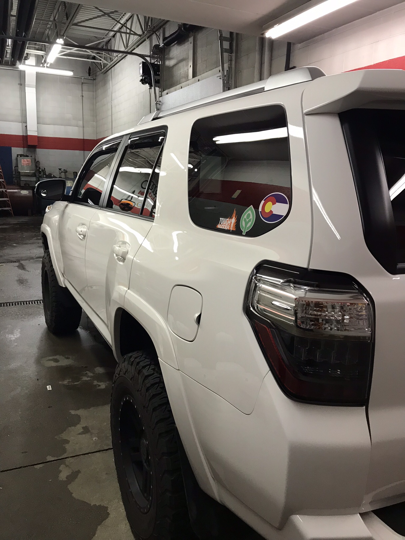

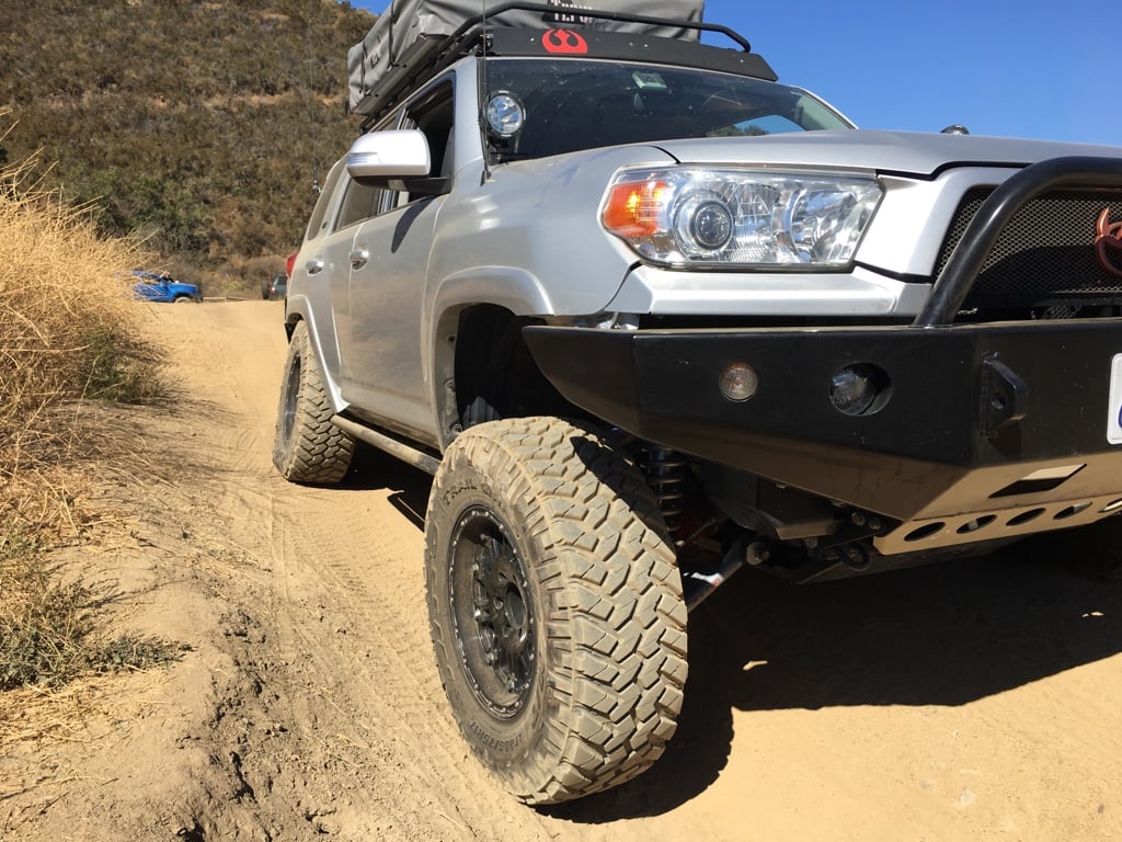

I run 17x9 +1 on 285/75/17. No issues at all. I do have bmc and fenders trimmed however

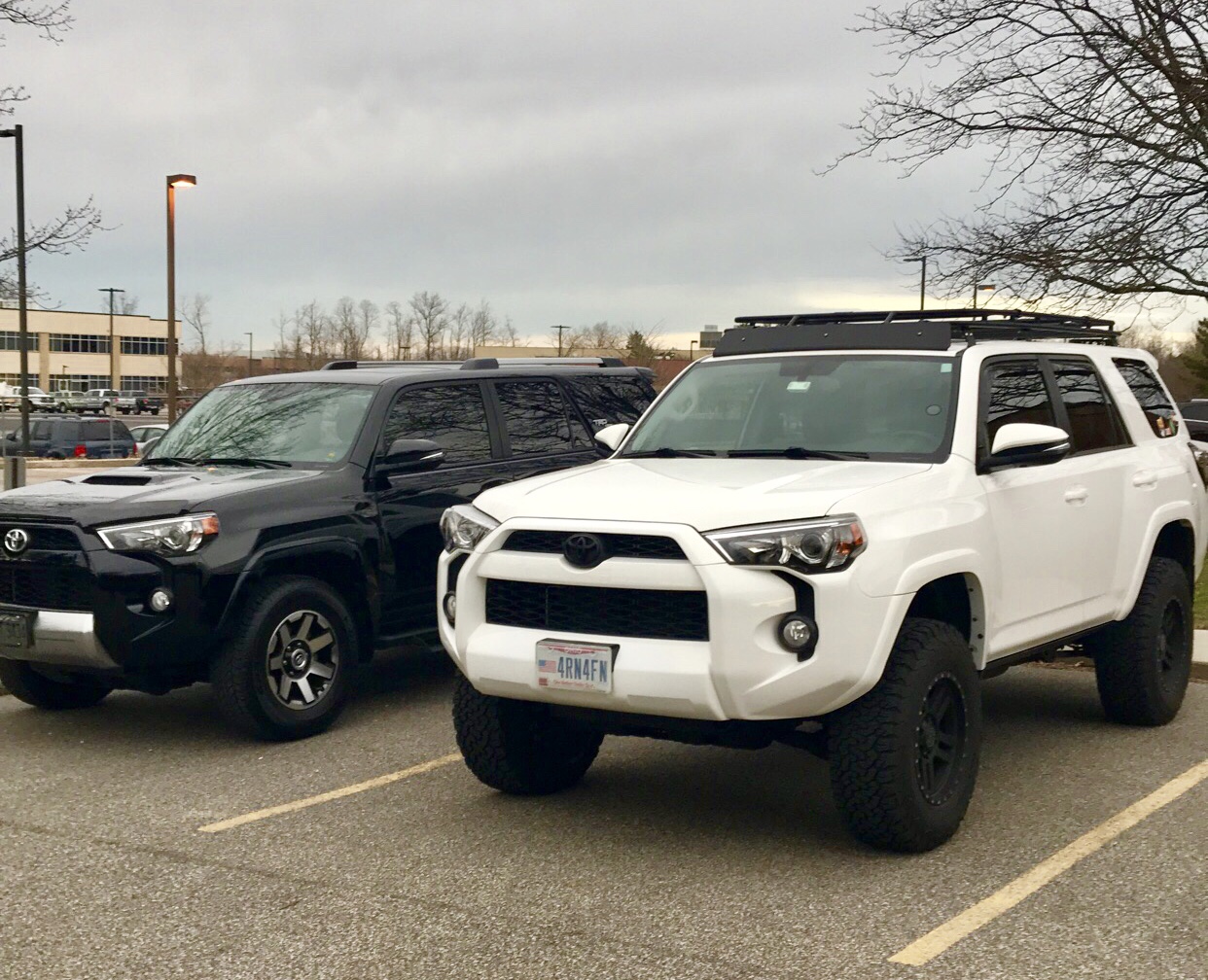

I decided to keep the stock TEP wheels because they are f-ing beauties 17x7.5" +15 OS , Just wrapped em with 275 70 17 BFG KO2s and they get that nice bubbly look to them over the wheel now I just need to push em outward to the body fender flare line or just slightly past with a quality spacer maybe 1.25" a SpiderTrax or.....? any recommendations or thoughts
currently I have no rub or scrub issues with the 275s of the stock wheel and a procomp 3" level
Yellow....I am running the 1.25 spacer under my 17x9 Mambas and just trimmed the rear liner and mudflap mounts while keeping the flaps.
