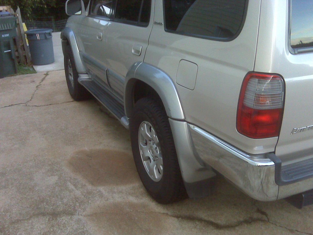

they run about 30 bux shipping each to my part of the world. i wanted black originally but it aint happenin. the wheels are going on a desert dune runner, which i think will look sweet. what im wondering is if they will "stick out" further than the current rims if that makes sense. i dont know the right term, backspacing maybe?

Also, to answer the question you posed earlier, these wheels actually have more backspacing than the stock 3rd gen 4Runner wheels meaning they will actually be a little more tucked in than stock. If you don't have a Limited it shouldn't look too bad at all, but if you do have a Limited or the larger painted SE flares, then you might wanna look into spacers. Wait til you get them on and judge for yourself.

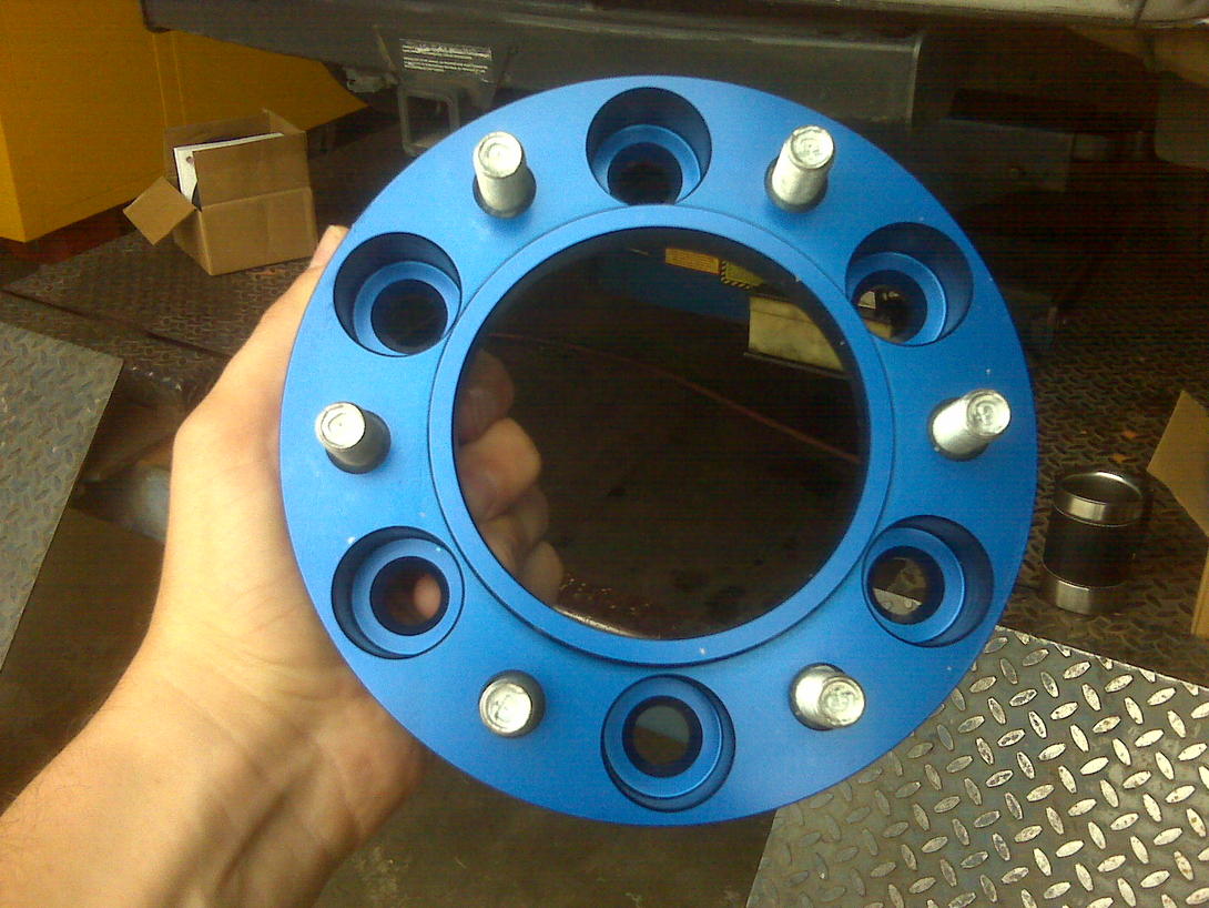

good to know. i own an SR5 with the large painted flares. can you direct me a bit on spacers...brands, amount of spacing, etc? im wondering though, by moving up to a 265/75 form a 265/70, will that offset the difference?
I just got done with that whole thing, 2000runr. I got Taco TRD rims and it left my truck looking like a train car. I got Spidertrax(www.spidertrax.com) 1.25" spacers for $99 a pair and it cured the problem. Nice wide stance now with Wrangler 265/70's.
mind posting a pic or sending me a link to previously posted pics of the look? i actually hung up with my toyota dealership and they said the exact same thing, spidertrax 1.25". curiously, why did you go 265/70 versus 265/75?
I'll post some before and afters with the spacers when i get off work if no one else has by then. I also went with Spidertrax 1.25". One tip.. look on ebay. They retail at $99/pair but I bought a set of 4 brand new off of ebay from Spidertrax directly for about $140 because they were "blemished". Strictly cosmetic. If you don't have the cash to put up for the Spidertrax at least try and find some spacers that are Hub centric and not Lug centric. This can lead to a spacer not being centered and a vibration.

Actually they can get gunmetal or painted alum. The painted are not shiny, and with the dune actually appear more attractive. Spacers ordered also, thanks for all the help.
Can't wait to see it....I'm lovin' the spacers so far. Although I do get a little vibration at 70mph that I never noticed before. Could just be a bad balancing job though...
