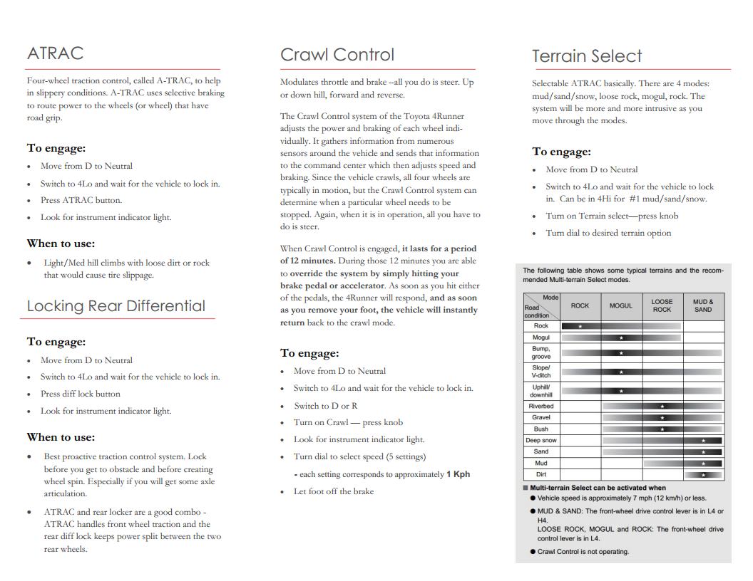

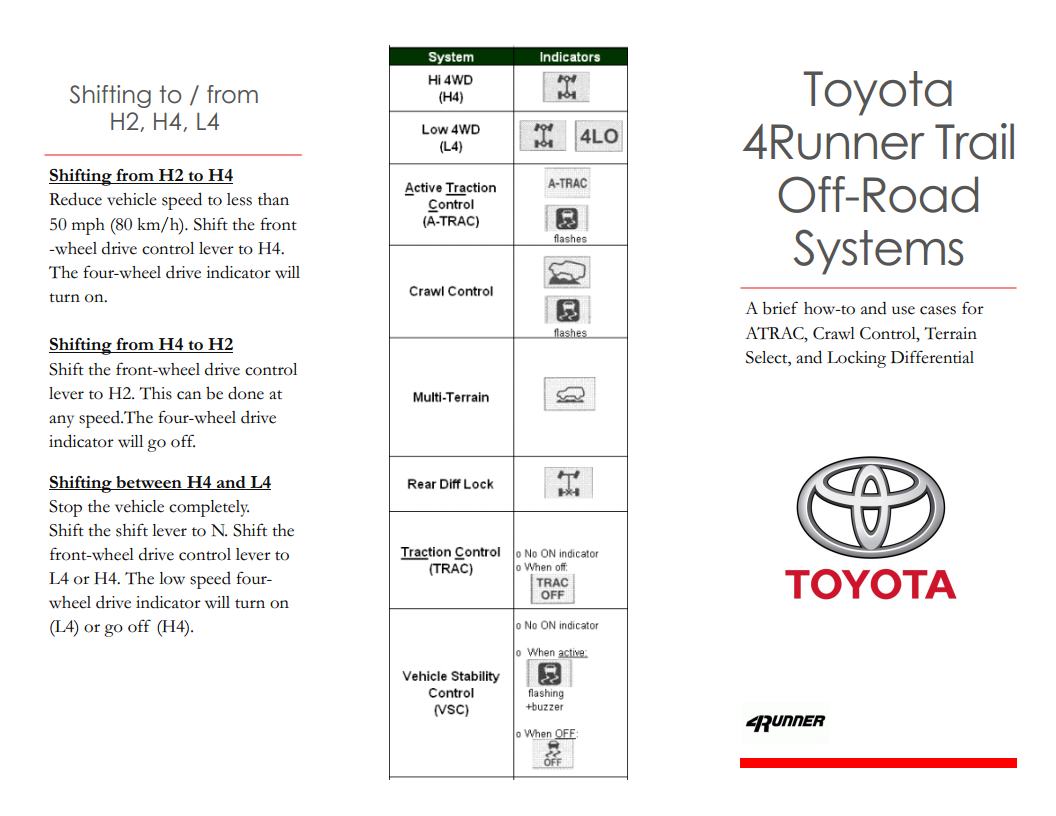

This may be worth posting again (grabbed it from another thread, I am not the author)...
