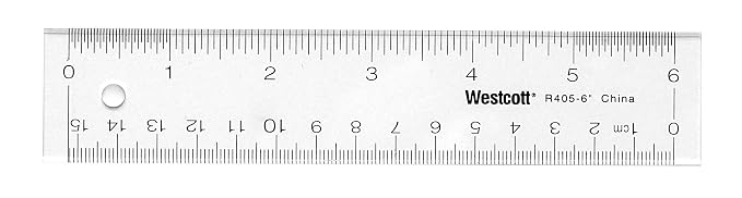

mileage is not a good gauge for rotor replacement.. measure the runoff with some common household tools..
take one of these:
https://images.homedepot-static.com...scent-adjustable-wrenches-ac210vs-64_1000.jpg
PLUS
https://images-na.ssl-images-amazon.com/images/I/718Cmlp0kXL._SX679_.jpg
-take off wheel
-clamp down adjustable wrench
-slide adjustable wrench off rotor and measure w/ ruler
OR
if you have measuring caliper then even better
to be honest your service guy was just trying to make a quick buck off you. If your caliper needs replacement then its just a simple 2 extra steps more than a brake pad change
