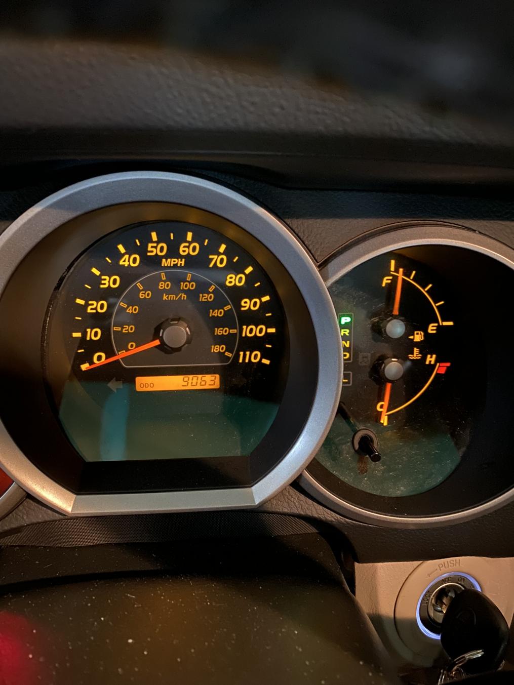

How many miles on your rig now Ralph?
Here is a picture on my 08 4Runner's Odometer as of today 09/16/2022 (9063).
I keep trying to drive it more but fear someone cutting it's cats off, have enough problems with jerks keying it.
