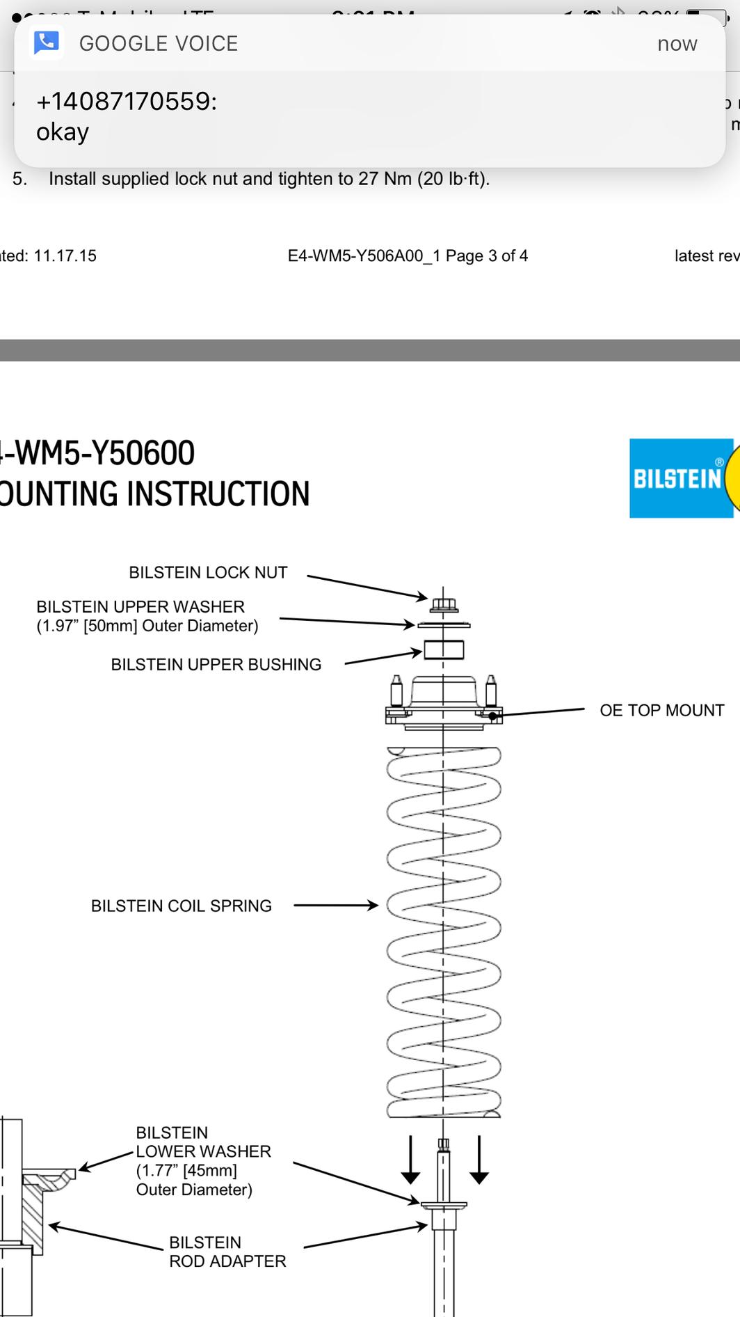

Seems like I'm missing all the items under the hats

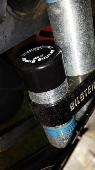

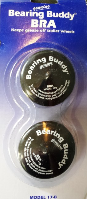

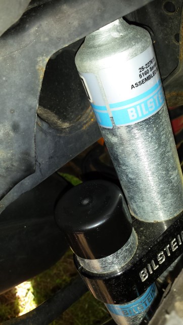

[MENTION=103267]Saker[/MENTION], I picked up a set of Bearing Buddy covers tonight at O’Reilly Auto Parts (model 17B), 2 for $3.69. I can confirm they fit perfect!!!!!!!! They fit real tight; actually I stretched the open end a little with my fingers to make it a little easier to get them started, then pushed all the way down (no lube necessary), the suction created will definitely prevent them from falling off.
View attachment 158308View attachment 158309
Installed!
Wasn’t keen on the white lettering, nothing a little lacquer thinner couldn't fix! I know, I know, I have a problem :loco:

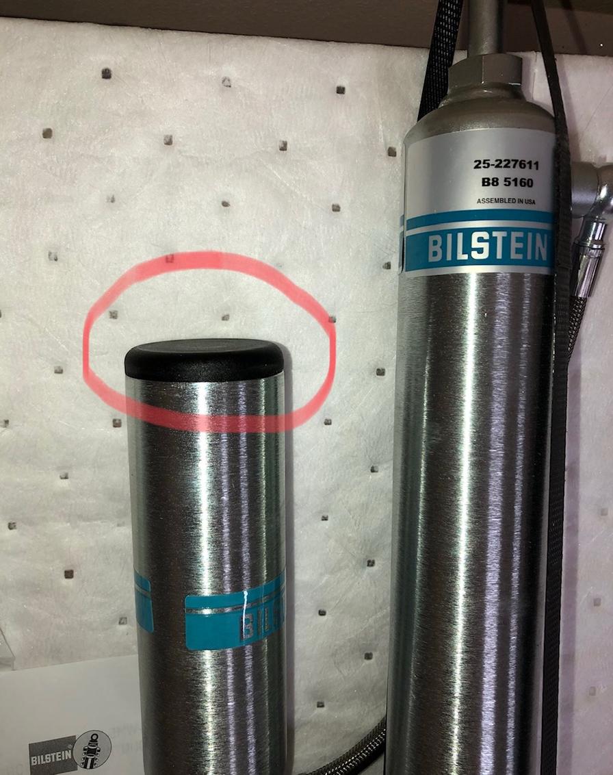

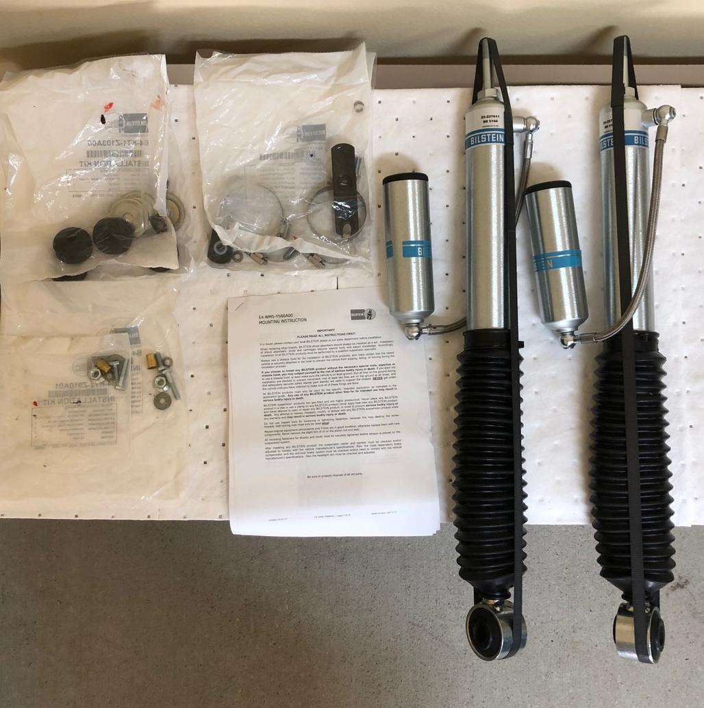

I replaced my 5160's today.
I had a torn lower boot on one of them.
Reason for this post is to show what Bilstein has done to improve the issue we addressed with the open reservoir area.
They definitely did an improvement here.
See photos:

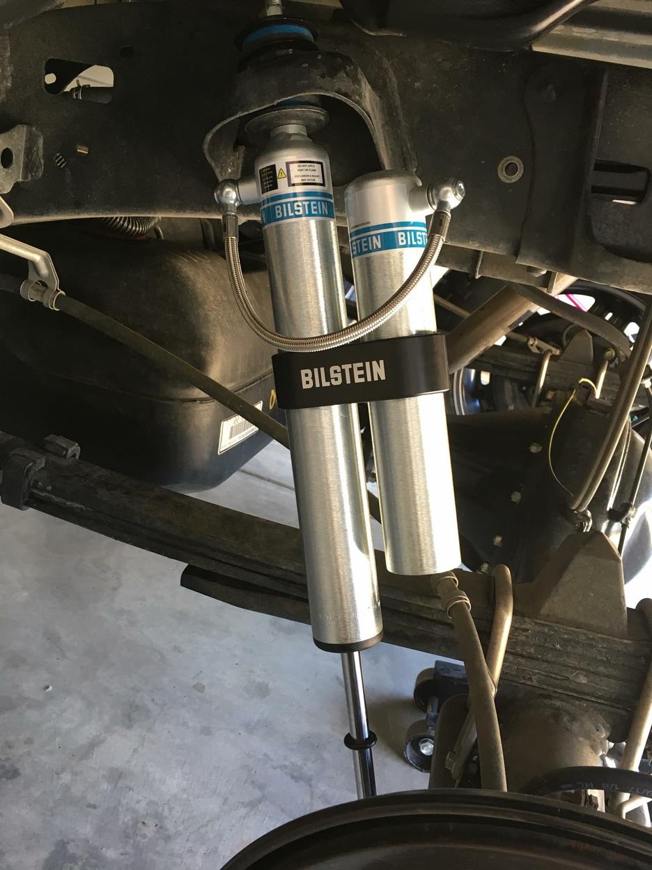

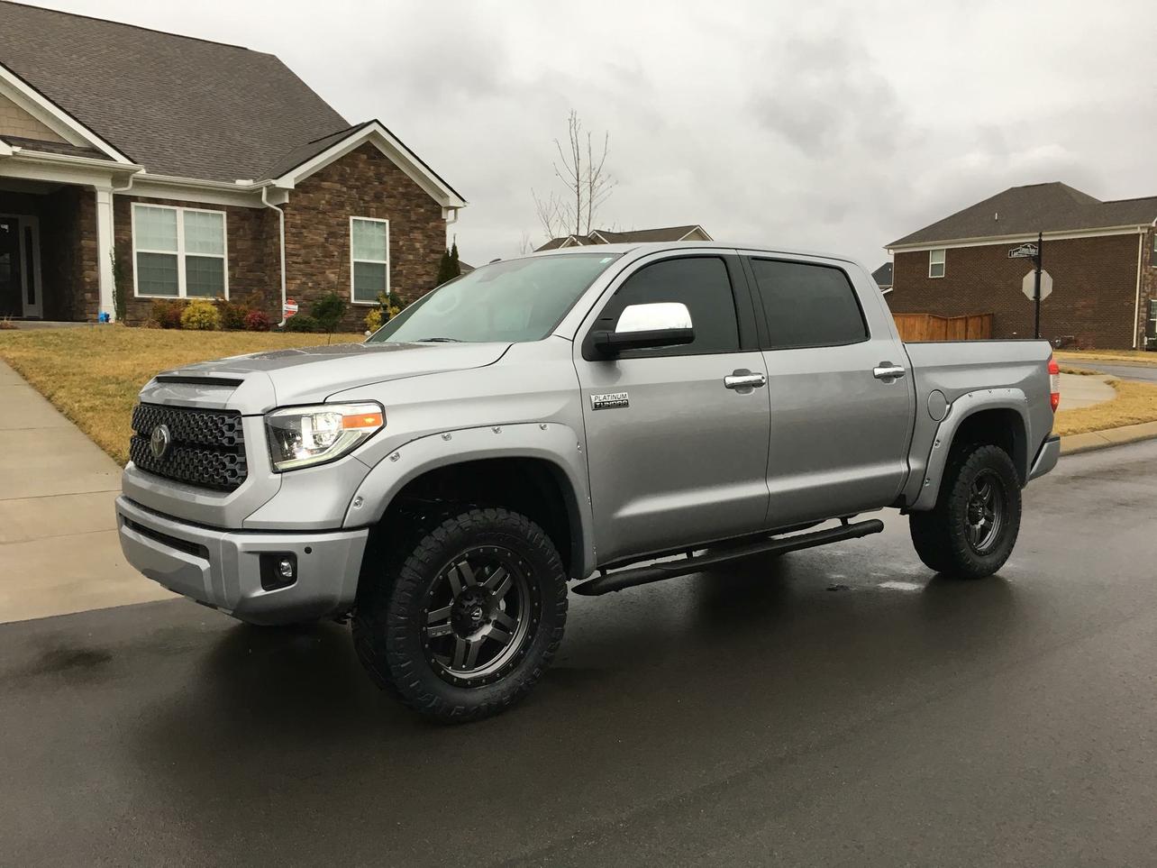

Interesting. I sold my 4Runner over three years ago and now in a 18 Tundra platinum. Did the same Bilsteins 6112/5160 but my reservoir is the old style
