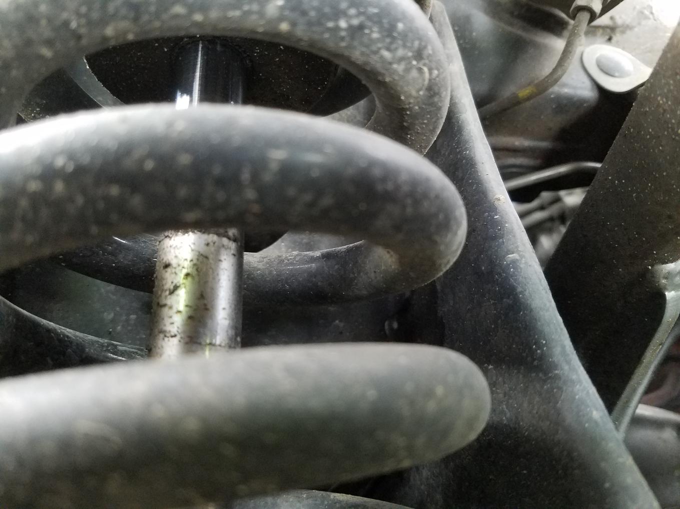

Just my luck, looks like my mine is starting to give. Barely resolved my rears a couple of months ago and now this...
I'm starting to lose trust in their products. Granted, they have their limited lifetime warranty but the hassle of time and money to un/installed and then alignment sucks. And I have yet to test the limit of the 4runners. This is my daily driven, weekend trip and camping with the family, no rock crawling or high speed rough terrain driven. I'm really debating if I should get kings or something equivalent but I guess those requires interval maintenance every 20k or so....

Sorry to hear but thanks for the info.
As you may have seen I was debating what to go with because of concern with reliability. I ended up going with Kings. They are a lot of maintenance imo, but I figured I would rather have my 4Runner down every 20k-30k miles for a shock rebuild with better performance then every 10k-20k and having to haggle about warranty and etc. At the end of the day the additional money for the Kings didn't seem too bad. (I hope their customer service is as good as everyone says, at least I hope so if i have problems.)
