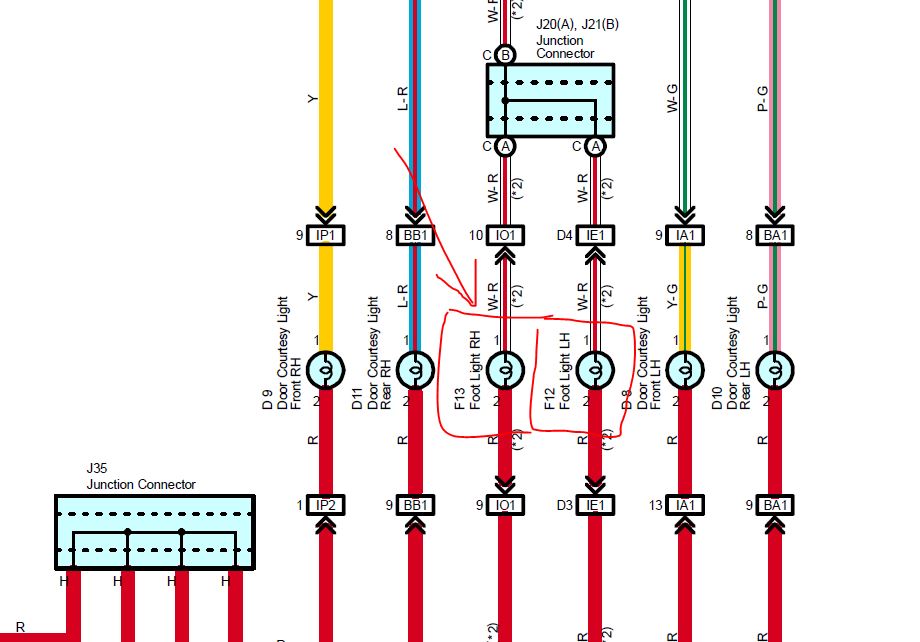

Where are the "foot lights" that I found on the EWD?
alia176
Senior Member
I have a Sports edition so maybe I don't have these lights?

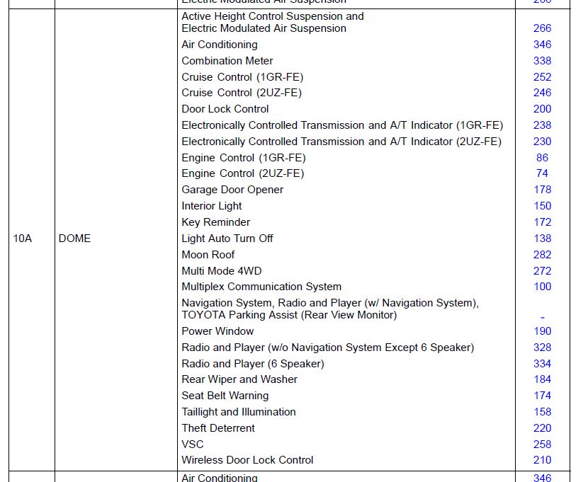

I'm trying to figure out what's causing my dome light fuse to blow.
- disconnected all door lights
- " both dome lights
- " both visor lights
This has been a random issue and I don't think it's in the lighting circuit. Let me disconnect the factory alarm to see if that does anything. The only other thing the dome light fuse supplies power is the HVAC control panel. The clock, and mpg are resetting to zero after turning off the engine each time.
Your Body EDC and Skid Control ECU also run of that 10A Dome Fuse. You could have a short there too.
I'm not sure if all cars come pre-wired ready for courtesy lights. I think only Limited gets those.

Interesting info, thanks for that. I overlooked those systems being fed by the same dome light fuse. My traction control works normally so that system is ok but let me see what's up with the body EDC. That dome light fuse serves a lot of circuit, like cruise control, engine control, tail light, power window, VSC, air conditioning, etc., and yet, they all work normally minus couple of things.
This is interesting!
