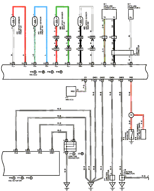

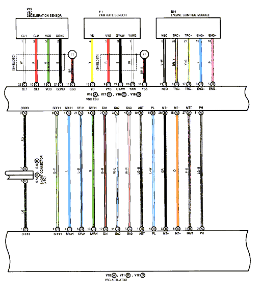

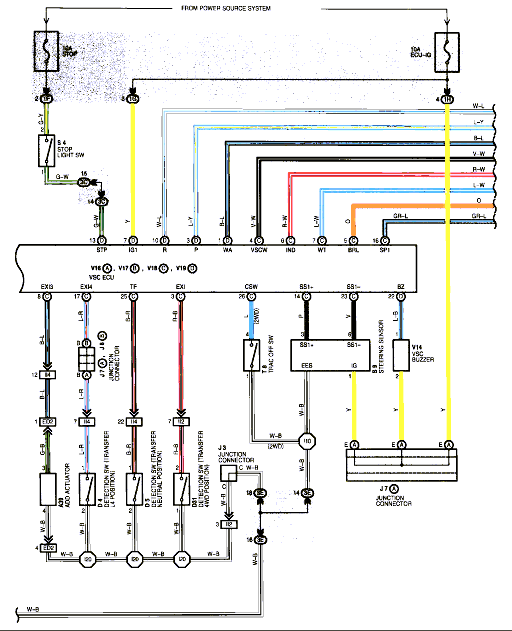

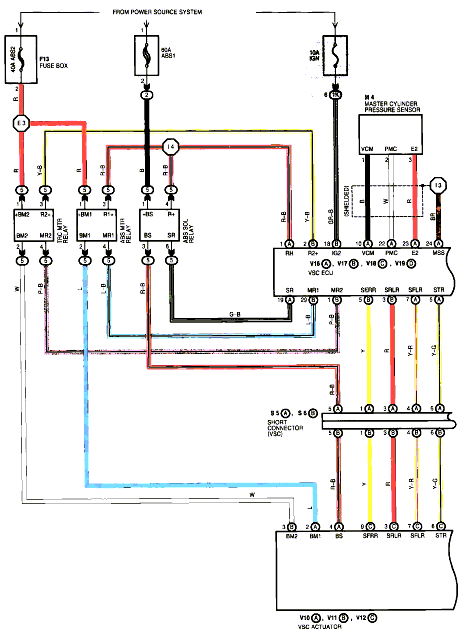

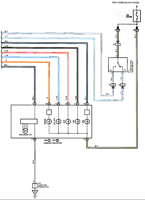

How are these? Are they what your looking for??
