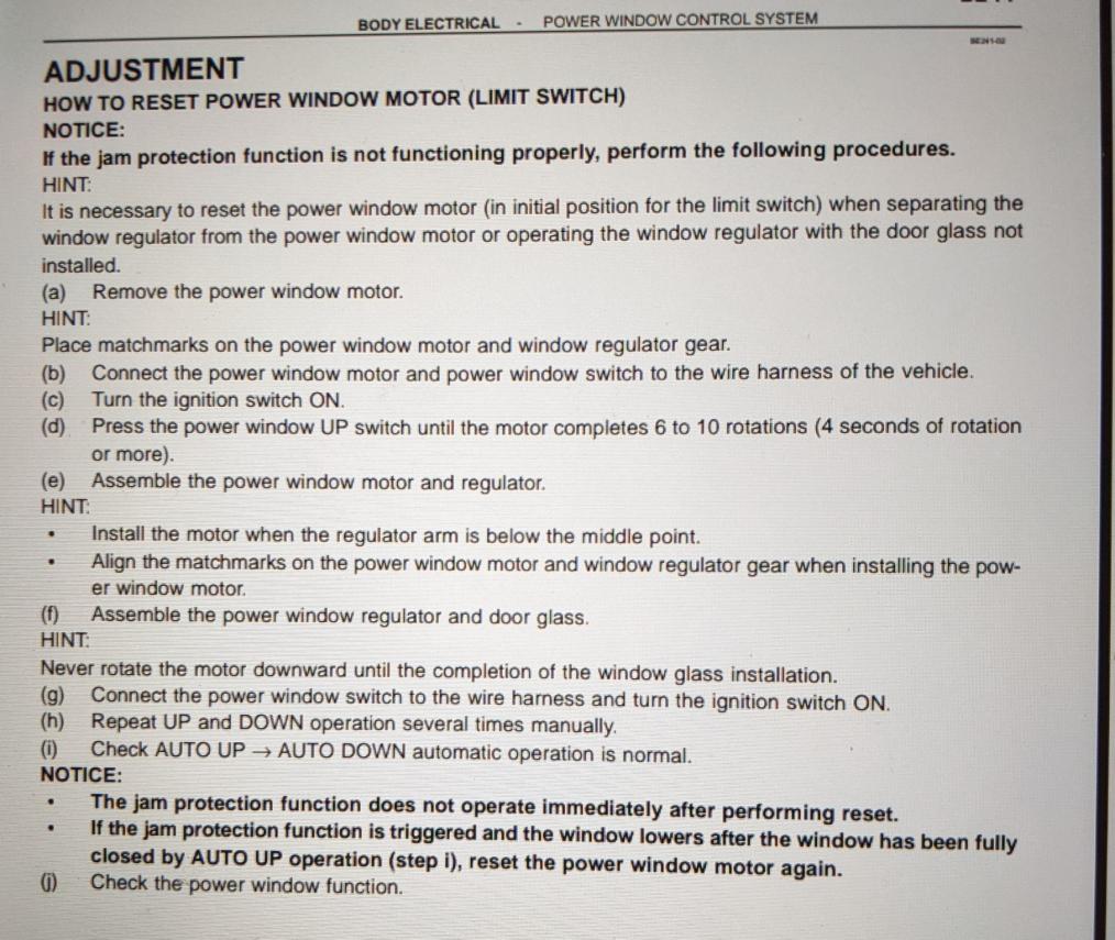

Current symptoms sound like jam protection function. May need motor limit switch reset.
Notice: If the jam protection function is triggered and the window lowers after the window has been fully
closed by AUTO UP operation (step i), reset the power window motor again.

BUT now the driver side wont stay up. It hits the top and acts like theres an obstruction and comes back halfway down. It was late last night so just managed to get it mostly up for the night. More troubleshooting ahead.
Don't use the auto feature and you'll be able to close it just fine (first click, not second click). There may be a re-learn procedure (most new cars have it, and the auto up systems generally require it), though I haven't had to do it on my 4Runner.

still haven't found definitive method for resetting the motor...
One of those 576 :), BE-71 - Adjustment - How to Reset Power Window Motor (Limit Switch).
It's the 576 part that gets me. The adhd brain. Although, tbh, was hoping the solution did not require door dismantle (and kept seeing posts suggesting otherwise). But ultimately you're right. Attached for future reference (and searchers)
