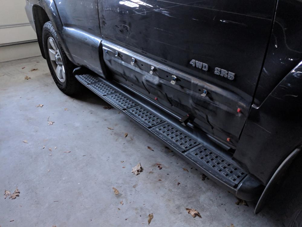

My wife came home one day and this trim panel was hanging by a thread. It pretty much broke off and all the plastic rivets are smashed. The panel itself is pretty beat up too. Looks like someone hit her in a parking lot.
Where can I buy this panel, already painted?

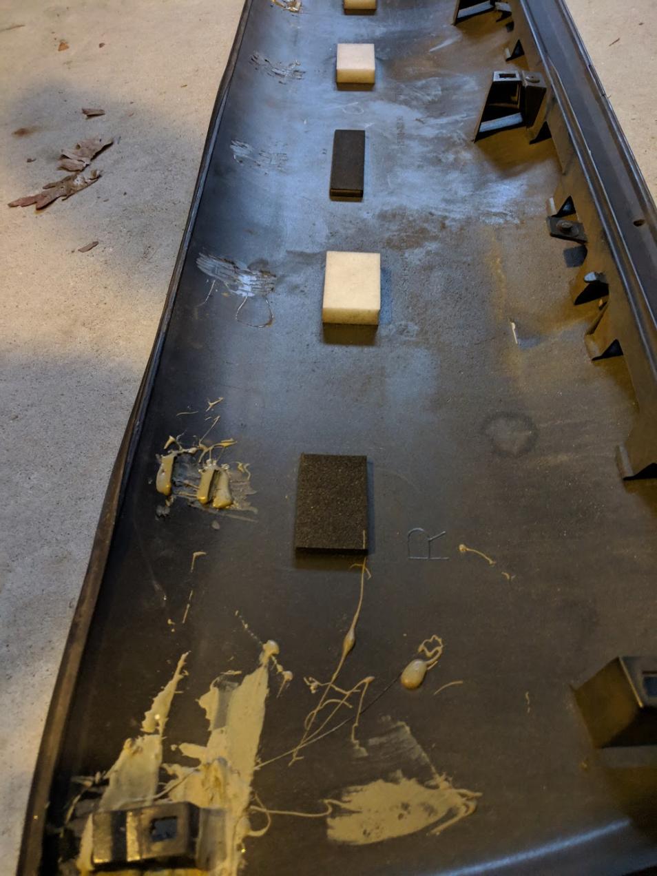

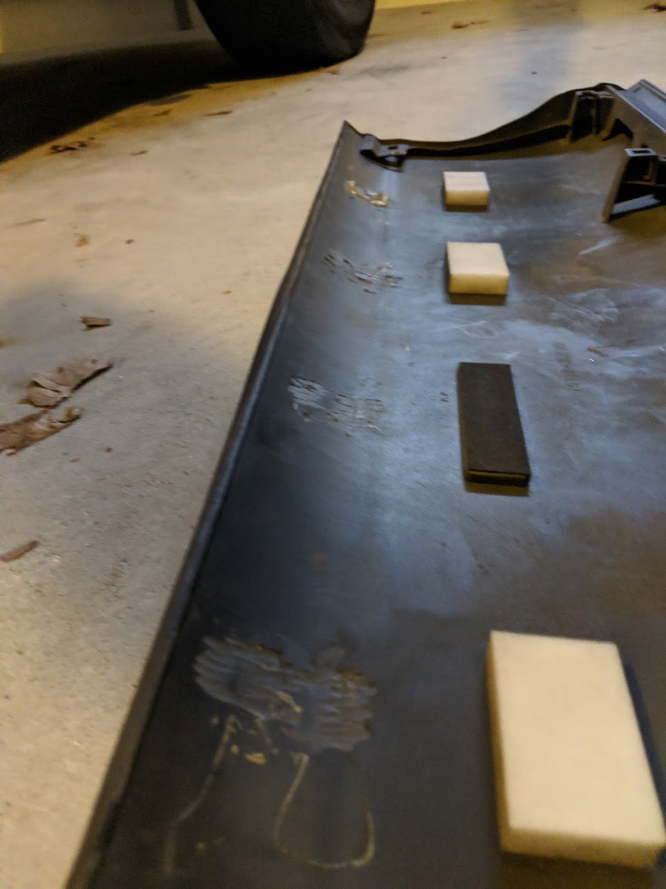

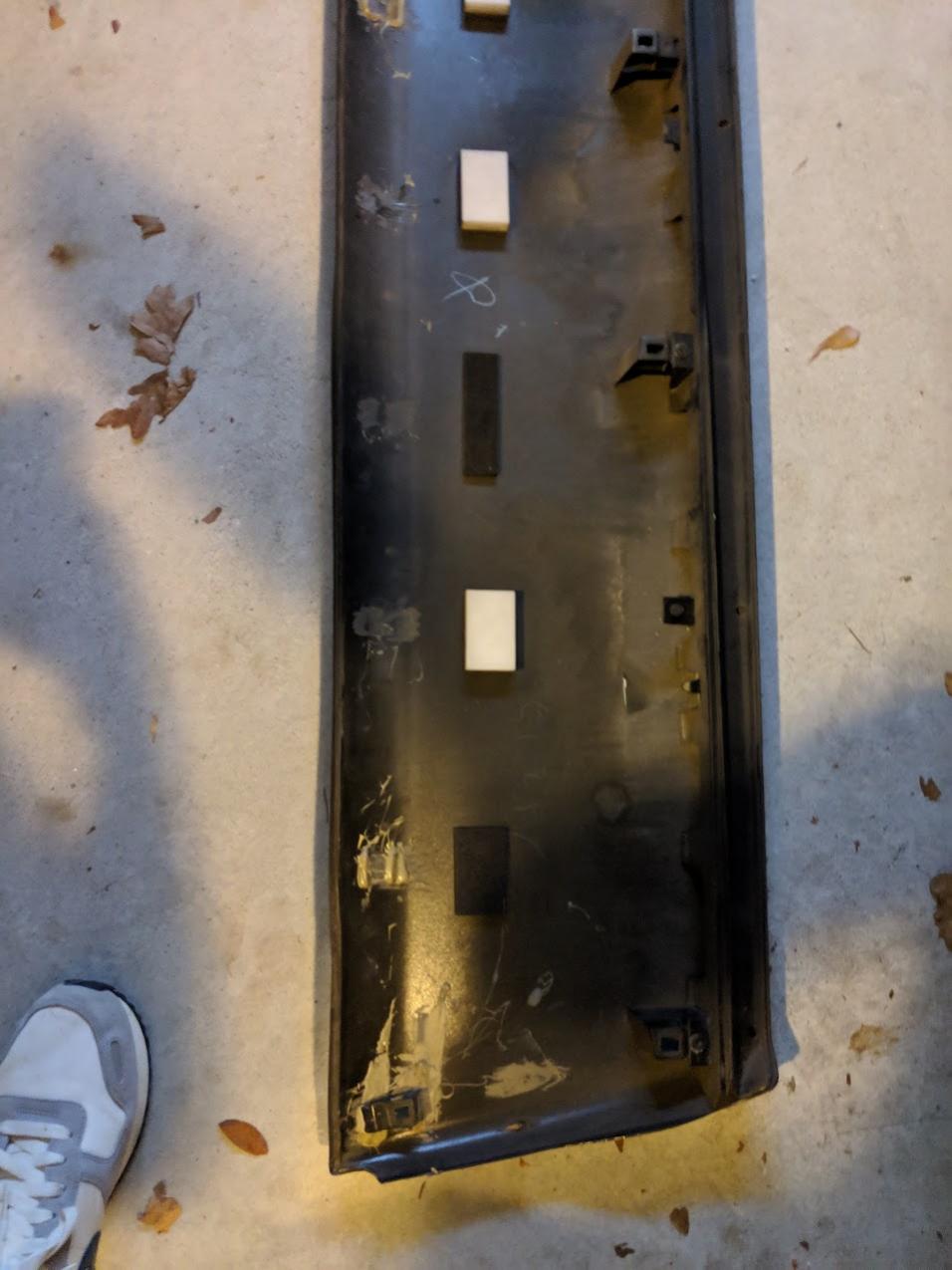

So i just got the part out, and realized i maybe need to buy a new panel after all. All of the connection parts where the rivets attach to the panel are broken off. What in hell did my wife do?!

I have never removed my cladding so I'm not sure what I see in your photo is normal from Toyota, but I'm saying not, it looks like someone removed it in the past and broke the attachment points off and then roughed up the back of the cladding with a Dremel so an adhesive would hopefully stick and epoxied them back on, very sloppy looking not something I would expect from Toyota, that being said if you have all the missing pieces you could possibly put them back on using epoxy as it looks like was done before by someone, but that maybe why the cladding was knocked off this time, as I don't think the epoxy will hold very well, IMHO!!
I was thinking the same thing. Almost looks like Liquid Nails or similar. Definitely not what I would expect from the factory.

Your part has been repaired once. The bad thing about trying to buy a 12 year old used part is that the little blue and orange clips that hold the part on don’t always break before the little tab on the cladding does. I have removed most of the cladding on two of my 03. At least one tab broke on each panel. They are a pain to remove.
It was already ripped off and glued back on. Mine look similar from ripping them off on the trail. I just gorilla glue the connectors back on, pop new clips in, and reattach until the next time it rips off. Check eBay. I've had good luck buying trim pieces there for fairly cheap or pick a parts. Galactic Grey Mica? Hard to tell what color from the pics but if it is that's one of the more popular colors. Keep in mind 03-05 is slightly different trim from 06-09.

Yes the clip areas on your piece are broken off and have been re-glued. My statement was that when the body cladding is removed, being that plastic is 12 years old, sometimes the part not the clip breaks. Then you are left with a piece with broken clips areas, just like you have. Like it's been said try re-gluing. It worked for awhile with your truck and you didn't even know it.
