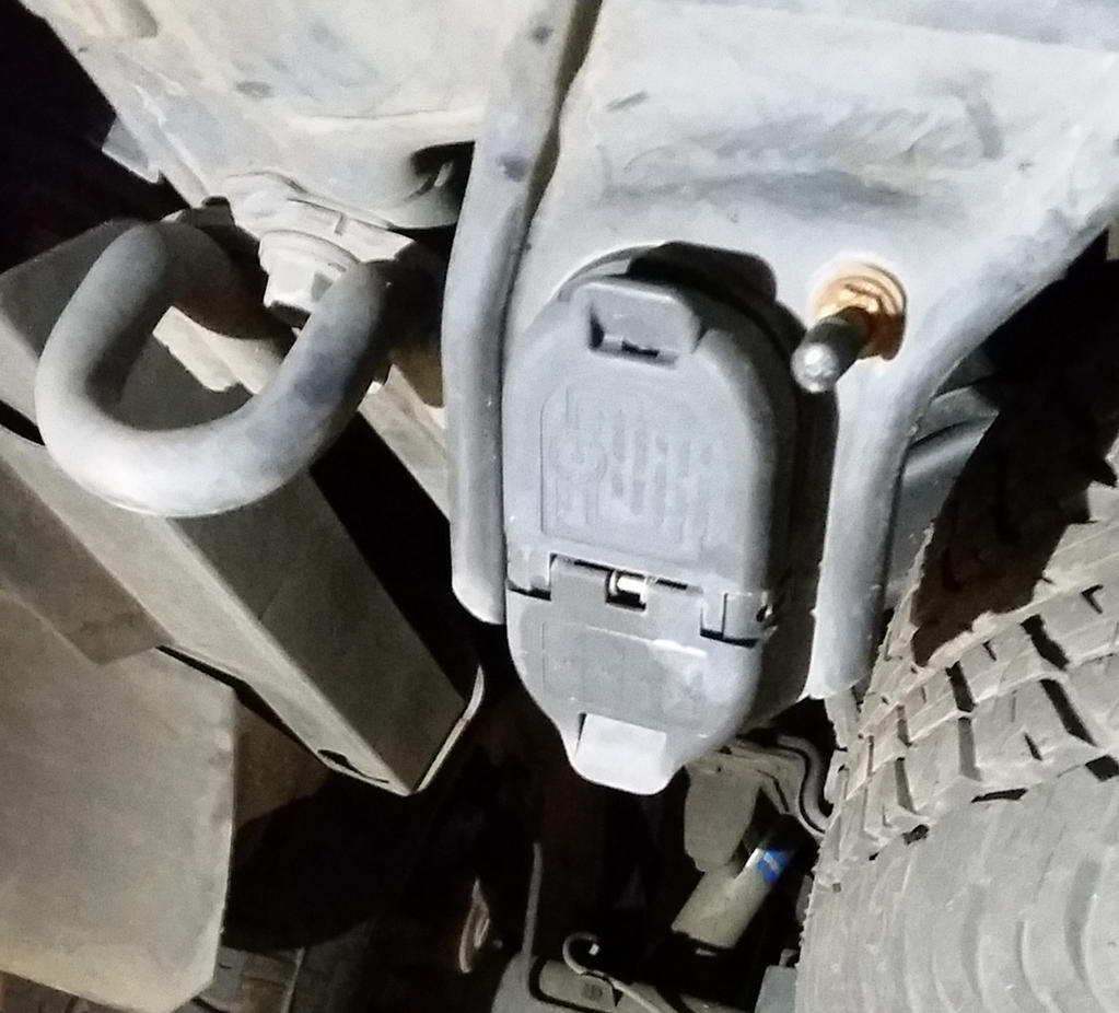

I took a simple approach and mounted the air filler on the small panel that also has the two light connectors. Drilled a hole and put the valve stem in.
Is that inside the vehicle or outside/underneath?
[MENTION=65614]Antman[/MENTION] steals all my ideas...what an ahole...
Outside, underneath. In the same small panel that has the trailer light plugs. Yes, it's a PITA to reach, just like the trailer connectors. Out of the way when off-road, won't get torn off.

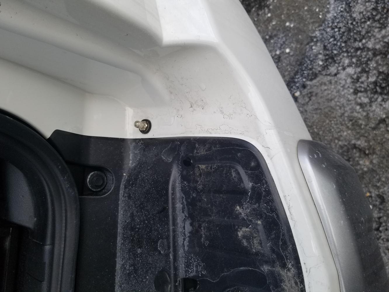

I tried to find my old photo, but gave up. Went out and got a new one.
Awesome, thanks! Makes sense since I will mainly be inflating when towing.

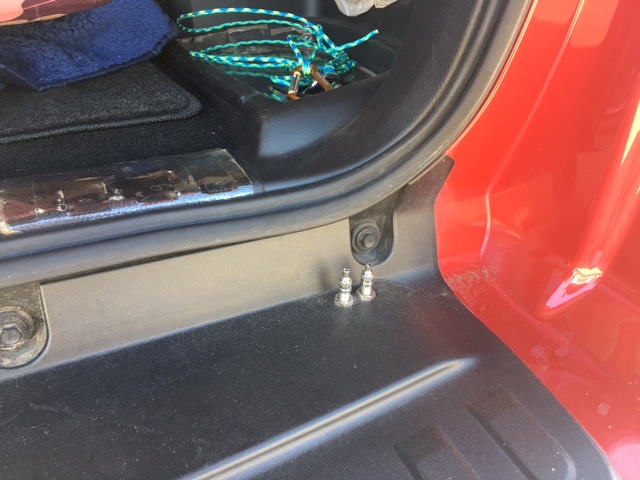

This is where SDHQ installed my valves. Easy access, lift gate closes fine, easy to fill bags. Easy to push down on tire gauge rather than pushing sideways.
