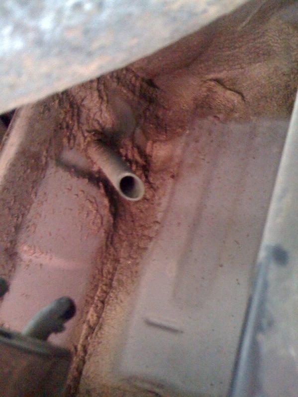

My sunroof leaks, and I know the common solution is to check the drain lines to see if they're clogged. Well my sunroof also doesn't open so I can't get at the drain lines from the top, so am trying to clear the drains from where they exit instead. If that doesn't work, I'll remove the glass and try to get at the drains from the top.
I think I have found one of the drain exits, there is a plastic tube sticking out behind the right rear wheel, near the spare (see pic). Is that coming from the sunroof? I can feed about 5-6' of weed whacker line up there before it won't go any further. I am not sure which pillars this drain line follows, but regardless, I would think the entire run of the drain line from sunroof to exit would be longer than 5-6'. So maybe I have found a clog.
But I know there is another drain exit somewhere, I have read archives and spent a lot of time on my back under the front part of the truck looking for another exit hole. I just don't see anything. Anyone got a picture of where the front line exits, so I know what to look for?

To clear the fronts, you have to do it from the open sun roof. The exit is at the bottom of the truck frame between the pinch welds, so you cannot access it.
Run some weed eater line down each corner drain hole in the front. Pour some water in each hole to verify water is coming out.
For the rears:
Passenger side is easy. The drain hole exits under the back of the truck, basicly under where the little storage compartment is. You can see the 2" or so of tubing sticking out. Run your weed eater line up it, spinning it as you do so to "rooter" it out. Maybe apply some slight pressure to it to blow it out.
The drivers side is harder.
You have to remove the rear plastic panel to access where the drain tube runs into a catch pan, pretty much below the gas filler as a reference. Once you access the tube, repeat with line, air, etc...

All 4 corners
1997 4runner----DONT HAVE TO REMOVE THE HEADLINER.
the rear drains are as stated . behind the rear wheel , just put a shop vac to the hose & suck any blockage out.
The front you can get to by opening the sunroof, Use an air hose to blow the drains out.
1996 4runner , the rear drains out behind the side part of the rear bumber, there is an oval plastic filter looking thing . it drains from in there.
