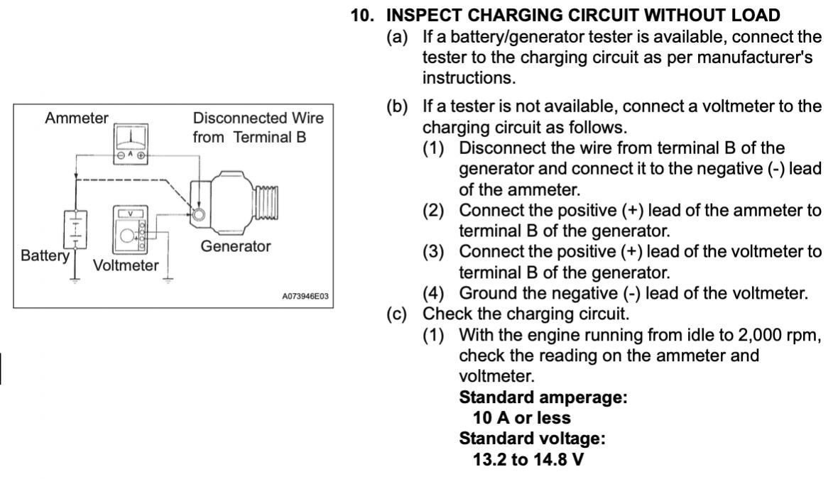

Where does ECU get system voltage?
From the FSM for 1GR-FE
You know what, I never considered that the alternator wasn't producing the correct current, just assumed that if the voltage was good the alternator was good. But checking the amps its putting out is a good idea. That could be the issue.
Thanks for the suggestion.
I don't have a designated ammeter, assuming a standard household multimeter should work? I've got a few so I could set it up like the FSM suggests (with a spare set of hands or 2) to measure voltage and amp output.
Depending on how long my cables are I might disconnect the big cable (cable B) off the alternator, I think it has a ring terminal, and use alligator clips on the multi-meter to clip onto the post of alternator w/ one and ring on the other to complete the circuit. Or I can run out and grab some fresh cable and make up a new one to run it to the battery.

I read in a post that you can get the volt measure from the alternator by connecting the multimeter to the alternador post. It’s easily accessed you just need to remove the plastic cap.
Now. If you follow the Alt-S fuse in the engine bay, there are 3 wires that connects to a plug just below the alternator post. I believe the PIN4 is the one that goes to the computer.
See attached
There are a couple of other alternator plug threads so I'll continue over there, but my plug only has 3 wires, not the 4th lower right ECU wire. So when I get a chance I'll try to figure out which one feeds the ECU. Hardest part is access to the alternator side of the plug while the engine is running, especially without a lift / garage, not to mention it has been stupid cold.
Might try to find a matching plug online and make up a test harness so I can have better access to the wires. Other than check engine light and maybe a few other codes, shouldn't be any problems running unplugged?
