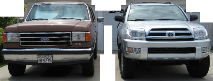

It is funny to compare them as the early 4Runners were "Baby Broncos" with the fiberglass add on shell, two doors and a tailgate power window. It ironic that the 4Runner outlasted the Bronco! Shame on Ford.
My model year Bronco is a little large compared to it's 1960's grandparents, but it is still very capable. The 3 speed C-6 trans is bulletproof and has no computer to die. The 5.8L V-8 is a beast with direct port fuel injection and gobs of torque. The axles both had Factory limited slips with manual locking hubs on the front and a 2-speed transfer case.
Full sized Broncos came only in 4WD. 2WD was never optional.
It boasts a great 35 foot turning radius as well as:
Angle of approach 37.5 degrees
Angle of departure 23.4 degrees
Breakover angle 24.9 degrees
Ground clearance (lowest points with stock tires)
-- Front axle 8.1 inches
-- Rear Axle 7.8 inches
-- At Breakover 9.6 inches
Most everything underneath had stock skid plates of fairly tough steel. You could often bash rocks with the axles and not care.
The stock front axle was a hybrid that had a center pivot point called "Twin Traction Beam" with dual shocks and large coil springs.
I think it was my first American auto where I did not have to slam a door. to make it close It would close easily and with a satisfying click. Overall fit and finish was good but does not compare to a 3rd or 4th Gen 4Runner at all.
The rear bumper is all steel and recently a 99 Beetle rear-ended me at 40 MPH. The Bug was totaled. I got a new bumper for $250.
A stock Bronco can whup a stock 4Runner in most everything off road except where smaller size will get you through places more easily. A Bronco can carry all of your gear internally whereas my 4Runner had to use a roof basket on my last trip.
A 4Runner lifted is a different story.....
On my Utah trip my friend had a stock Sequoia, sort of the size and power equivilant of the Bronco. Many times I stopped for photos while he ambled ahead. I could race across the desert roads and easily catch him. I climbed two difficult sections with more ease than he did and I garnered better gas mileage too.
A 4Runner is more like a smaller but very refined modern Bronco: quiet, reliable, solid drivetrain, great amenities and cool styling.
It is a little more like a sports car than a truck but built quite tough. I really love mine without any guilt. The Bronco will stay in the family for a long while but the 13 MPG and 32 Gallon gas tank will keep it on a short leash.

Sweet description. I am familiar with the full size bronco but obviously not a familiar as you. I thougt it was called a twin I beam setup. My 91 explorer had the same setup. The idea behind it was that it would give you the strength of a solid axle while the ride of an ifs. Obviously it was a trade off in between each but still worked well. The funny part with that type of a suspension setup was that if the caster was set the same on it they would pull. Setting it up with a differance in caster side to side resulted in them driving straight.
And yes the one I had the an oppourtunity to play around in one that was a friends. It got horrible gas mialage but I really thought about buying one for a while after driving one around the mountains. I loved the 351W engine. I remember how usefull it's approach angle was over my explorer. If could get places I couldn't in my explorer simply because it's front bumper could clear the steep obsticle when the explorers bumper would be pushing into the dirt/rock/ snow or whatever....(one of my few complaints with the new 4runner is clearance at it's front skid plate)
:cheers:

My family owned two Broncos through the '80s and into the '90s and they were tough but quality had some issues and the fiberglass tops didn't deal with sunlight very well after 6-7 years even if you cared for it. My parents had their '84 for 5 years before my mom rolled it then she got a new '89 and kept that through the '90s and it finally croaked out at 140k as it was just falling apart after 11 years and now my mom owns a '99 Runner Limited and hasn't looked at a Ford since.
My dad handled the off road chores in the '84 quite a few times and it handled underbody scrapes nicely but it's width caused a concern sometimes and most trails in Colorado can be narrow.
Nice trucks for their time and a solid off road performer due to it's solid construction but to say it whups ass on a stock 4Runner (3rd gen) is a bit of an exaggeration. My '99 only has an inch bigger tires and has clearance over everything on a stock Bronco by over a couple inches without my tires. I think they are comparable but the 4Runner does it much more comfortably and having a locking rear diff can be the difference of making it up a hill or not.

Mine has 265,000 miles so I guess my production run was a very good one.
I may not have been clear but my stock 89 Bronco could whip my 2005 Gen 4Runner (when it was stock) almost anywhere off road.
A 3rd gen has far more clearance than a 4th gen but that was Toyota's change.
E-locker was not an option for a 4th Gen but limited slips were for my Bronco. 4Runners have not been free of quality issues, maybe just less of them?
Agreed on narrow trails and I mentioned it earlier.
My Bronco is 16 years old (bought Jan '90) and the fiberglass roof is in great shape.
I think that the stock Bronco engine with 210 HP and 315 ft-lbs of torque will crush any generation 4Runner's stock V6. Probably have to look at power to weight ratios.

My Bonco and 4Runner side by side
