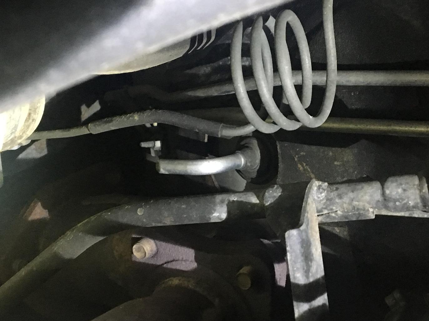

Just found a article online and decided to check out my firewall... is this the port that you're talking about?? It comes up right behind the ac-heater core

It is by the passenger's side firewall. Best accessed from underneath. Looks like a 1/4" or so rubber tube, or hose. Mine was of the same color of the body. Btw 02 Sport as well. About 2 years ago it got clogged with dirt and all the condensate was spilling in the cabin. I had trouble finding it, but this forum helped. Again, bottom of the firewall on passenger's side.
I hope that's the thing that you're looking for.
