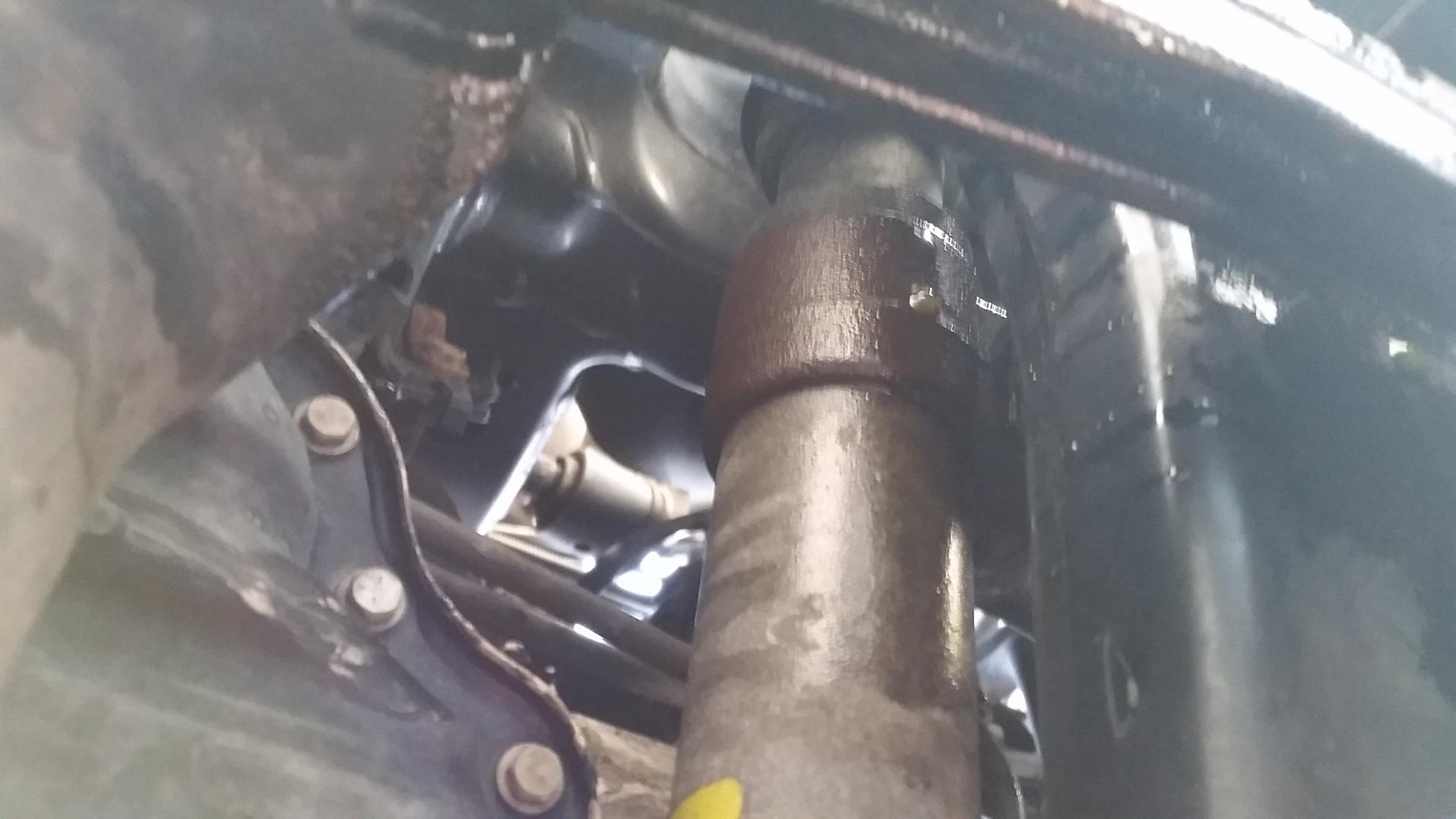

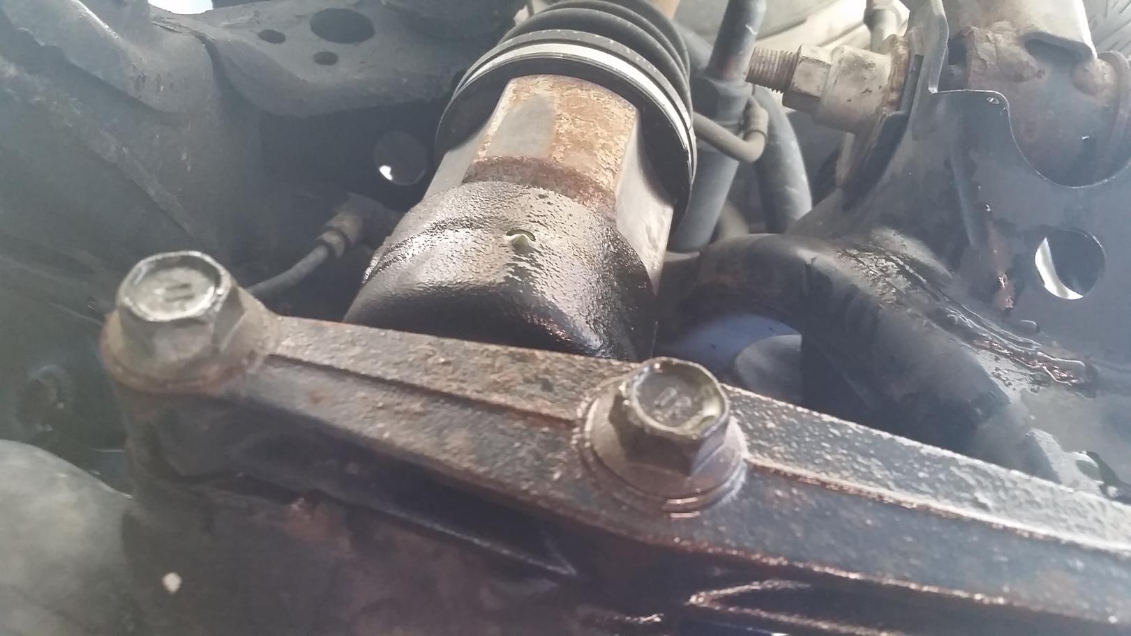

It's greenish in color so I'm pretty sure it's coolant. Leaking down onto steering rack on pass side. Hopefully you all can make out something from pics.

I really can't tell where it's coming from but Toyota coolant should be red or pink not green. What color is the coolant in your overflow tank?
Well first off the coolant is contaminated, so that's not a good sign to begin with.
I really can't tell much from those pictures to be honest. Can you see it from the top? maybe where it's dripping onto the axle shaft?
I can't see anything from the top. I was underneath for 20 mins and still not certain where its coming from. The most fluid is on the passenger side of the steering rack. Its weird because there is a lot of fluid on the rack but only a couple drips above it and i think those might be from the wind carrying it.

It almost looks like its coming out of differential seal. Gear oil? Its got really distinct smell, and new oil looks somewhat transparent. Hard to tell from the pictures but coolant should be more pink

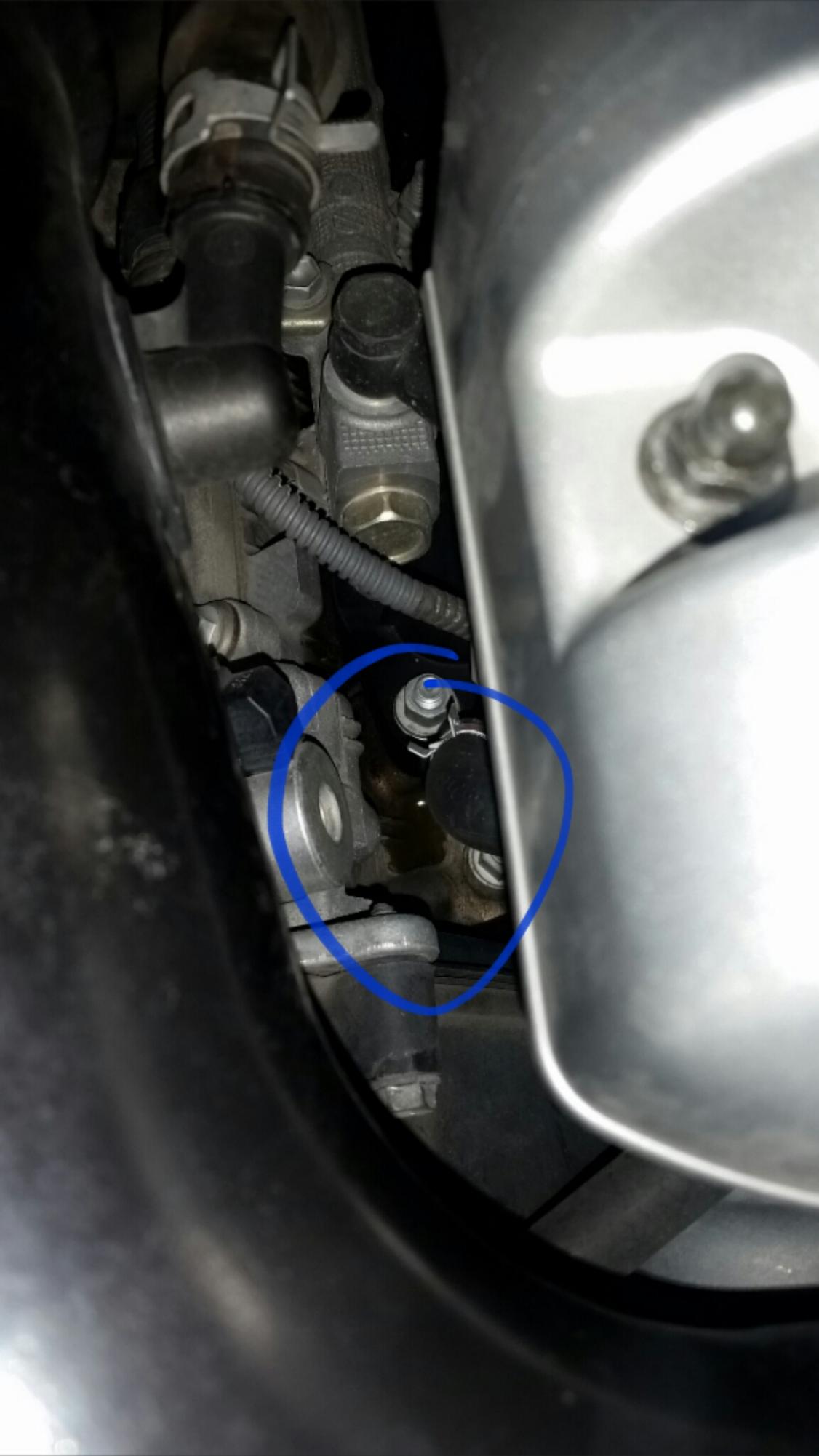

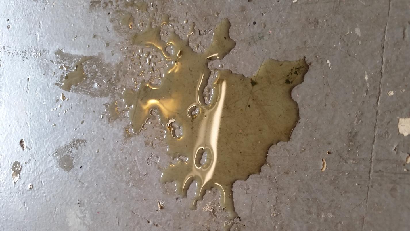

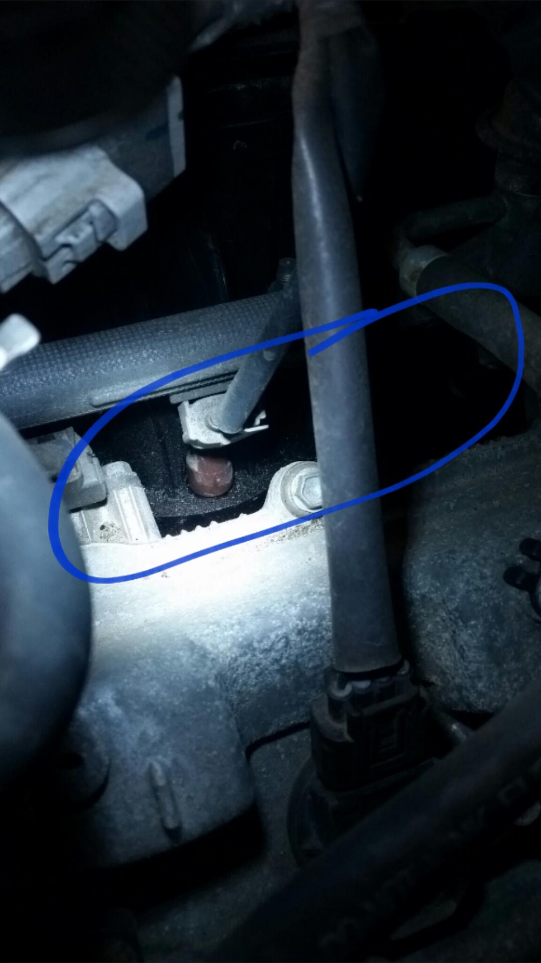

This first pic, there is a small puddle of coolant below the v8 engine cover. No clue how it got there or where it came from. Can you make this out?
The second imaged, which i'm not even sure is relatd to my coolant leak. Appear there is engine oil on right side of engine.

I found this previous post with someone with same issue. Here
So i guess that explains my coolant leak. However, there is still what seems to be oil on the right side of engine.
It's possible, I am not there to really look at the leak in person so it's hard to say. But I have seen that waterpump/thermostat assembly incorrectly sealed/installed before leaking.
Heard back from my mechanic. Leaking coolant from thermostat housing gasket. Oil leak is from valve cover gasket. Hes going to replace both. Is valve cover gasket failure common with these engines? I only found one other thread that talks about valve cover failure in the 4.7.
