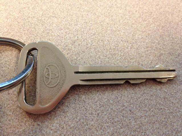

Where can I get a blank key? I checked eBay and they sell blanks with the transponders. I don't think mine has a transponder since my key is all metal (the picture is my key). And can I just get it cut by any locksmith? Thanks guys.

The subkey is the one you pictured. (rounded) It's the "valet" key. It does not work in the glovebox. On the chipped (transponder keys; which all have a rubber head) it supposedly sends a different signal to the vehicle's computer that it's not a master key.
No kidding. So the all this time I've been using the valet key without knowing it. That's the only key that was given to me by the previous owner. So I actually would want either the master is 90999-00186 or the master w/plastic is 90999-00185?
Yeah. Either one depending on if you want the black plastic one or not. The metal master looks like your valet but with squared edges instead of round.
