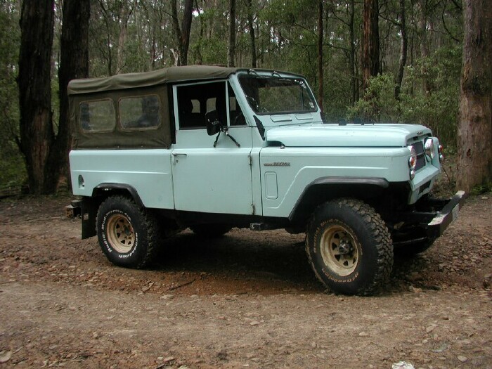

techno: Man, do you have any pics of your Patrol? Those things are so sick! I had never really heard of them until I went to Panama last summer on a surf trip and there were some really bad ass patrols there! Id like to see it
This is getting a bit off-topic but here it is...
'77 G60 Patrol, 5.7lt V8 dual fuel, 5 speed, rear air locker, MQ front discs, 33 BFGs, Landcruiser rear leafs with Defender long travel shocks, custom front suspension, 50mm body lift and some other stuff....

Pretty cool....
Mr. Lambdebois said:
Pretty cool....
INdeed! :bigok:
And sorry for the offtopic interjections! good luck with the air locker, I cant wait to be looking for an installer myself.
