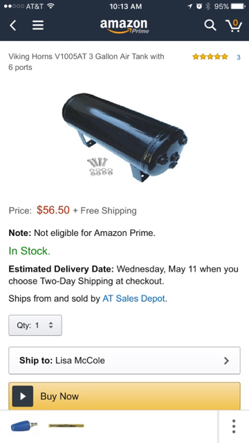

I plan on getting this

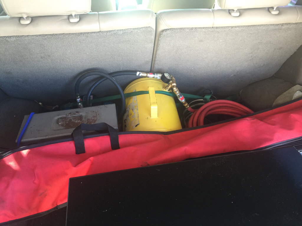

I ended up putting a 5 gal tank in the back with a small 2' 3/8" hose from compressor to tank.
It works really well. My compressor factory settings fill the tank up to 160 psi before it shuts off. My 25' hose lets me reach any tire or any other vehicles with ease. The tank is nice and leaves me plenty of trunk space as well. Strapped down by the 2 d ring hooks on the floor.
