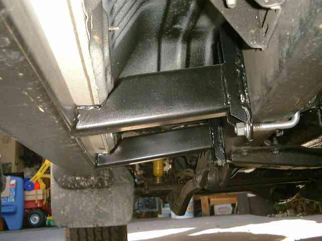

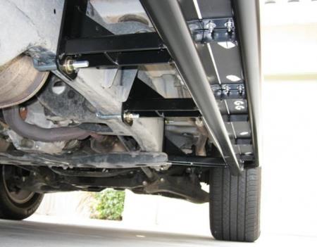

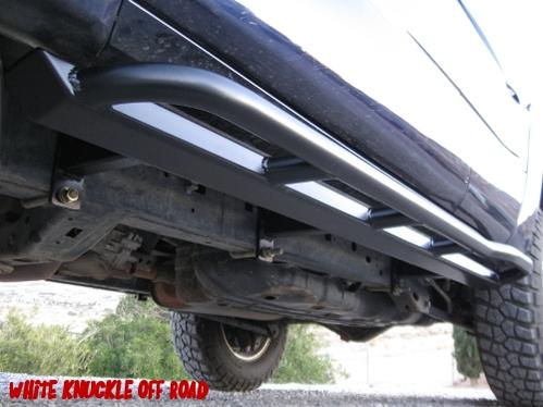

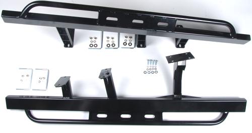

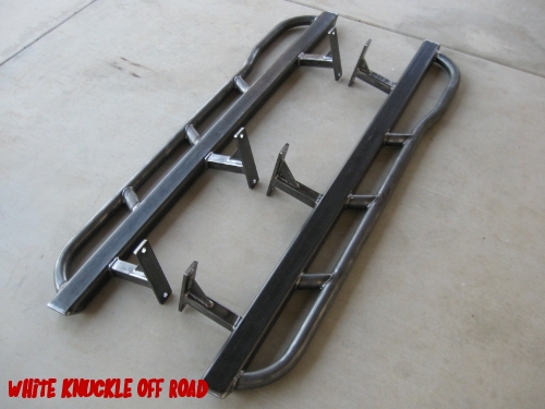

Yup, U-bolts for sliders; square U bolts to be exact. Been done on rigs with a chassis for a long time now, building my fourth set for a fourth rig. No issues thus far, been holding up well in the landcruiser world and they are MUCH heavier than our 4Runners.
Some pics of Whiteknuckle, SleeOffRoad, DIY like the ones on my 80.
From this thread on U bolt http://www.toyota-4runner.org/5th-gen-t4rs/118822-sliders-white-knuckle-off-road-3.html#post1110134
copy/paste
From John @ White-Knuckle
or whatever it's worth. I reached out to John at white-knuckle regarding concerns with the u-bolts.
His response:
"They are held on with Ubolts. I have been using the Ubolt mounting method when possible for a number of years now on a few different vehicle models with no troubles. They offer great strength and easy mounting with no need for drilling or modifications. Since they are tough enough to hold an axle housing to leaf springs under tremendous pressures then surely they can (and do) hold the weight of the vehicle. They are very tough and handle all the abuse thrown at them."
