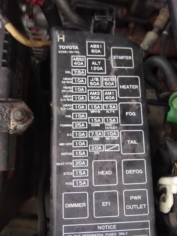

I'm have an over active ABS issue in my 2001 - ABS is kicking in coming to a stop at slow speeds when it's dry. I'm aware this is likely a wheel speed sensor issue and I flashed for ABS codes which pointed me to a likely issue with the front right sensor. Looks to be seated well, new part ordered, etc.
In the meantime, I want to temporarily disable my ABS so I can drive it safely until I can get the new sensor in. I have read a ton of ABS disable threads and I can't find a clear answer as to which ABS fuse I should pull in order to disable the system without any alarms or other issues.

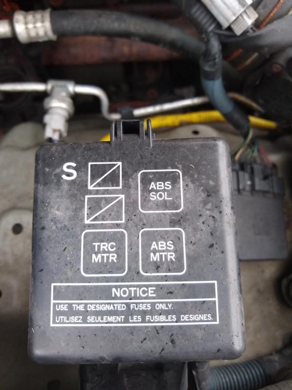

Under the hood, I have a 60 amp and a 40 amp on the driver's side fuse box, and on thr passenger's side I have ABS SOL and ABS MTR (which I'm assuming I should leave alone).
Does anyone know which fuse I should pull?
I also read that I'll need to unbolt the fuse box and turn it over so I can bolt the fuse itself from the bottom of the box. I'd appreciate any advice. Thanks!

Well, I pulled the 60 amp fuse and it completely cut power to the rest of the vehicle. I put it back it and pulled the 40 amp fuse and my power brakes seemed to be gone - no hydraulic pump noise and pedal was super stiff.
How else can I temporarily disable abs so I can drive with normal brakes until I fix the root issue?
Thanks!

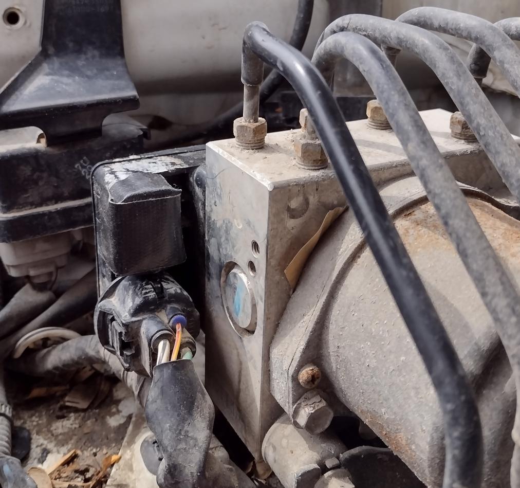

If yours is the same as my 2000 I unplugged this connector on the passenger side of the engine bay to disable my horrible ABS.
The one with the black duct tape on it.
Thanks so much - from what I've read they are a little different but I'll have a look and try that out if I can find the same one.
