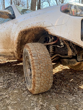

Ok so I'm new to the truck/off-roading lifestyle but I am learning as I go so please be patient with the novice question. I recently went trail riding at the Uwharrie Natl Forest in NC and had my first REAL experience with muddy, rocky, hill climbing awesomeness. The truck exceeding every expectation I could have ever had. I am trying to build my Runner to be as capable as possible and able to endure any novice mistakes I may impart on it.
I have a 3.5" lift, UCAs, Falken Wildpeaks and SSO sliders to give it a fighting chance but after seeing vehicles on the trail take some pretty nasty hits on the slippery rocks I have shifted my build plan towards armor.
Based on REAL WORLD off-road experience.....What pieces get impacted most frequently? Front skid, mid, rear diff, rear shock mount point?
I love the Victory4x4 skids so I just need to get some suggestions as to what to buy first.
Thanks in advance!
