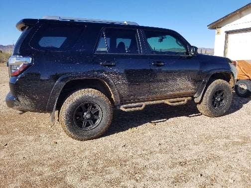

Live in Arizona. Been sticking to easy trails because I have the stock skid plate and Nfab nerf bars/step.
Now i have a little money to spend.
Skid or sliders?
Having been careful, I haven't damaged either. But watching videos of other 4runners on the local trails that I want to drive, I will want something more substantial.
I'm thinking of sliders first then hopefully selling the nerfs to buy the skid(s).
What do you think?
Avid sliders (localish) and RCI skids.

Truck came with the nerfs.
Also has 285 Toyo Open Country A/T on Mickey Thompson "Deegan 38" wheels (they don't rub)

Unfortunately those Nerf bars don't provide any protection... they mount to the same brackets as the OEM sidesteps.
