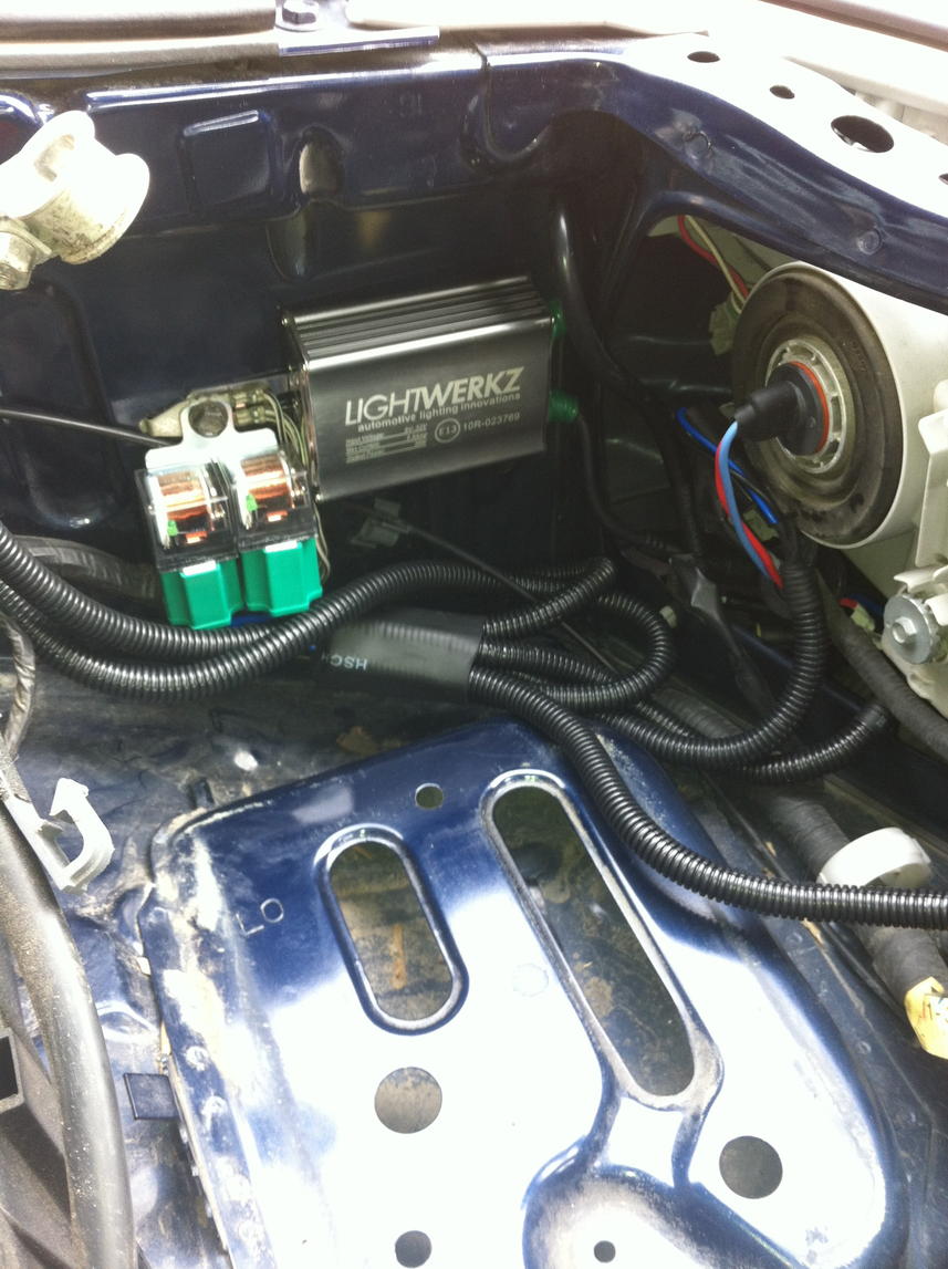

I have the Lightwerkz H11 in my lows and really like the kit I added the wire harness and it was a perfect fit, good quality too.

Nice set up! I got the same relays as you, only I installed mine are on the other side. Lightwerkz is a great company.
