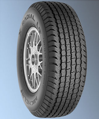

Here's a pic of the tire. Read on another forum that its Michelin's latest version of the LTX MS tire but sold only at Sam's Club, Walmart and Costco ... for a dollar less than the comparable LTX MS ... noticed it has six ribs instead of the five for the LTX MS.

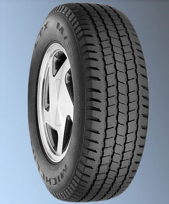

Michelin LTX MS
Here is a pic of the LTX MS ... a tire I once uses on another SUV and was very impressed with ... only problem was stopping on highway ... not exactly the best at that ... something Consumer Reports also found out ... otherwise gas mileage was great and so was the ride.
