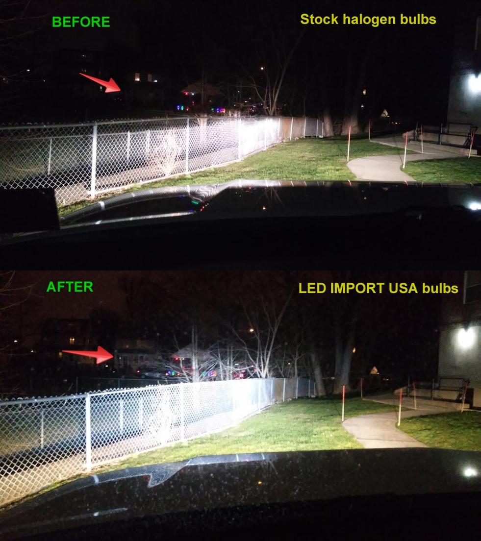

So I'm calling all you guys who had experience with LED or HID bulbs installed in 2010-2013 4Runner low beam headlights. Show me your projection, if the cut-off is there (or maybe better), and the lighting area is even or better than the stock halogen bulbs. I am looking only for 2010-1013 reflector type headlights, not 2014+ projectors. For the reference here is the cut-off line from stock halogen bulbs.
An for the first there is a comparison photo of LED IMPORT USA bulbs (from the thread deleted by OP)

I'm not a 5g owner but lighting has been a hobby of mine since I bought a HID kit back in 2000 for my Tundra. I'm currently experimenting with a LED conversion for reflector headlights.
[MENTION=113429]RysiuM[/MENTION] when looking directly at the headlights (might want to wear sunglasses or a welding helmet to dim the light) what areas of the reflector are illuminated? Is it basically the upper half and a "pie cut" from the center of the circle to about 4 o'clock?

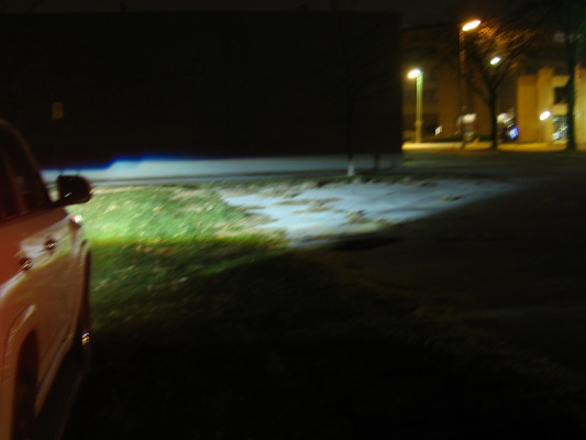

Plain and simple, if you run LEDs or HIDs with anything other than a proper projector retrofit, you will be forever referred to as "that dickhead with the blinding lights."

Well, yes and no. Right truck, previous retrofit (FX-Rs). Poor picture but I felt the need to show what properly retrofitted headlights look like. It's not all about the cutoff either; the beautiful clean light and the terrific spread too. The LS's are even better, but I spent a $hit-ton to get from 9/10 to 10/10.

Perhaps. I just felt that by now we should have realized that reflectors don't work properly with any light source other than a halogen bulb.
