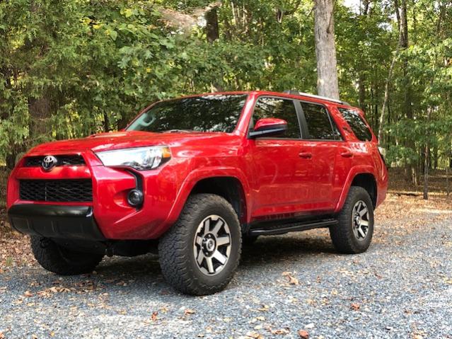

I went with the Bilsteins all around but slightly taller. 1.85" in the front and a 1.5" Daystar spacer in the rear. Stock size tires and stock UCAs. I've been pleased with the more firm ride without it being harsh. The pic will give you a frame of reference. My driveway has a slight slope which makes it look like the rear is lower than the front but that's not the case at all.

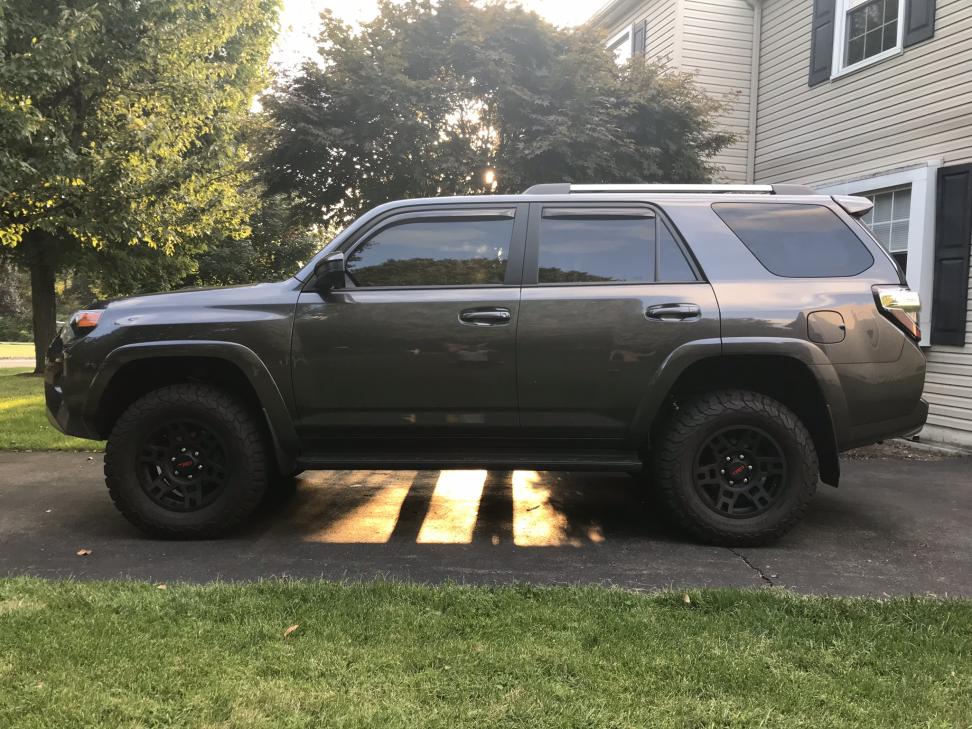

I have the following and love it;
Bilstein 5100's all around
Front, Toytec 112-620-P front Coil 1.6” lift, strut at 0.
Rear, Wheelers T13 1.5” lift.
Camburg UCA Ball Joint
