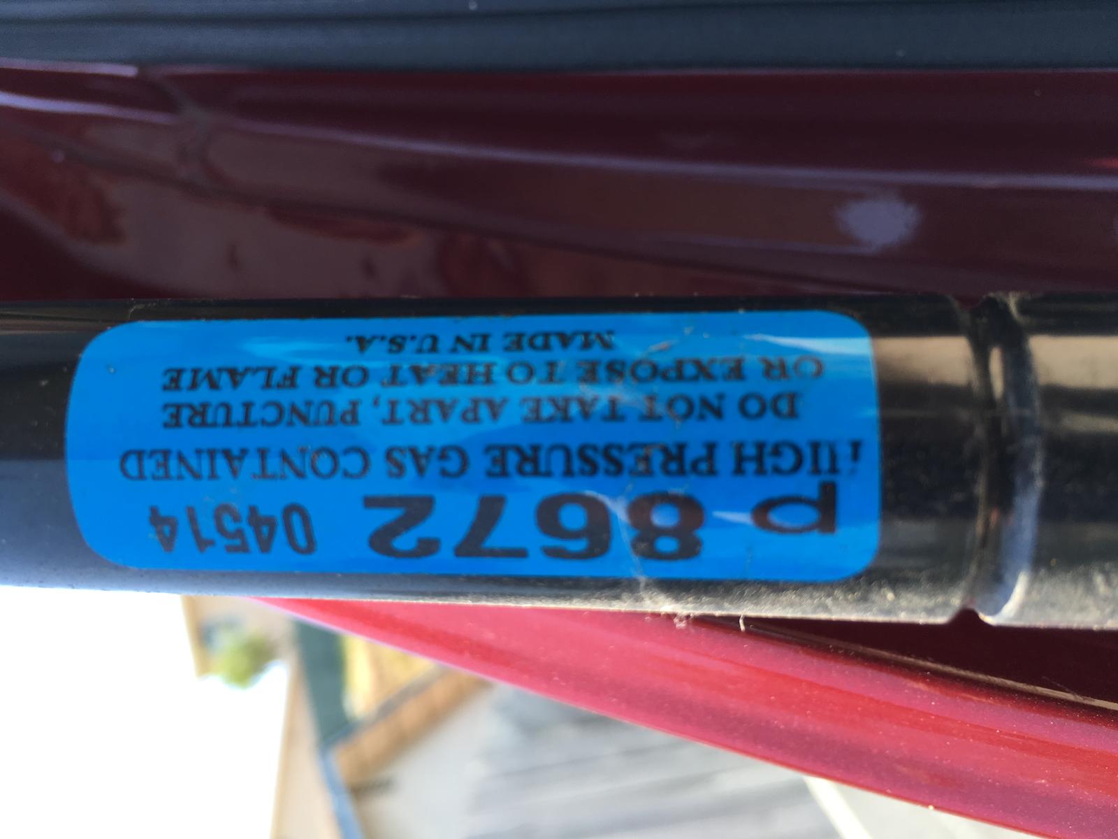

Here is a pic. of the sticker on the shock.
I just looked up that number (and a few variations) to no avail. I just emailed Strong-Arm to have them send me the part numbers.
[MENTION=58450]tmcintosh3[/MENTION] Did you receive any info from Strong Arm? What did you go with and are you happy? I'm looking to replace my stock ones and see two part numbers for Strong Arm. They show 4286 for 3rd gen T4R and also 6815 which they list as "added lift pressure". Wondering how these stack up to the Monroe 901446 as I just priced out OEM at $176...each
