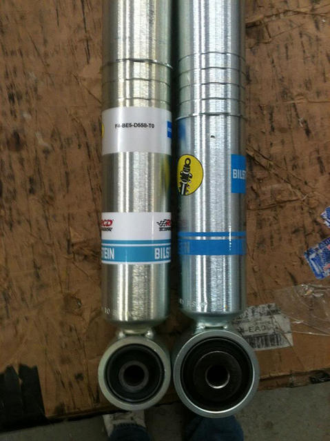

I'm on 2nd perch with Tundra 5100 and eibachs. Can't give you a # right now. But Tacoma 1st perch looks = to Tundra 2nd perch so on 2nd should be good and safe. My ride is good on road and off road. I'd eliminate the top spacer because to me spacers are shit and that's why you got an adjustable shock.

riding above the second perch is not a good idea. when you lift the front you lose down travel. with a 3" lift you might have 2" left of down travel. get a lower spring for the back, the front is not meant to go more than 3" of lift. the other issue is as you preload the spring more, the coils come closer together, and since the tundra coil is wider than the 4runner stock coil, it interferes with the spindle, the first perch actually is the best giving the most clearance for your spindle and ball joint, the second perch is doable however the spring must be aligned perfectly. the third perch is not doable without limit straps and then you will really have no down travel. the coils get so close that the spindle cannot fit between and smacks right into them, if you have yours on the third perch you will feel a hard clunk every time you go over a speed hump. these coil clearance issues are even worse with top plate spacers. the eibach coils that toytec sells are the stock diameter though and do not have these issues.
bottom line is adjust the front based on comfort then adjust the back. the shorter ome coils are not that expensive, and if you put the tundra coils or eibachs on a lower perch will ride much much better than tundra coils on the third perch in order to match the lc coils in the rear. if your concerned with how it looks than using a shorter coil in the back is your best bet, or just get a bodh lift. probably the best setup offroad is running 99 talls on the second perch with lc coils in the back, it gives the most flex.up front while still giving some lift.

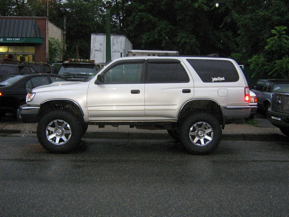

I dont notice any drivers side lean looks pretty even to me. I will take some pictures tomorrow and post up for the rear I left the rubber top cones out, lc coils I used where 7.5wrap pass and 8 wrap drivers/gas tank side.
I chickened out & went with the 2nd perch. LC 8 Wraps in the rear. The rake is good for me & I haven't added any weight to the cargo area yet.
looks great! really nice...i did mine today-same setup but with 1/4" top plate spacer on front driver side....all level...
