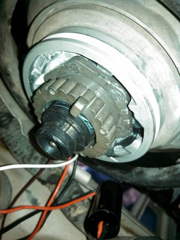

I have done both a Mini D2s 3.0 retrofti and an FX-R retrofit (3 times lol). Honestly after doing the Mini D2S on my last set I would nver go back to the FX-R because the output is the SAME! As for the fore ground light there is more than enough(almost too much). On top of that you would have no problem finishing a Mini d2s retro in a few hours whereas an fxr build could take days depending on the pace you work at.

I went with the D2S just because I didn't want to deal with aligning and drilling with the FX-R, and the H1 looked too small for our big headlights. But I was super close to getting FX-R. The D2S still requires some pretty heavy modification to the light (dremeling only), and I'm taking my time, so I probably could have just gone with FX-R.
Someone who has done a few sets before, could probably do a D2S/H1 setup in a couple hours, so that's a plus. But if installation time is not a big deal, I'd just go with FX-R.

I have had them side by side and can tell you the MD2S 3.0's are just as good as the fx-r's. I mean you know how I mod, only the best stuff if I truly knew that the fx-r's were better I would have them but they aren't anymore.

The MH1's have foreground limiters where as the md2s do not so that isn't an issue at all.
As for install its very similar to the mh1 but you have to take a sanding drum to the bulb retainers tabs inside the boot retainer circle. It is a super easy and quick job. Nothing like the fx-r's as far as cutting goes lol
As for the washboard roads I drive on gravel roads a lot and after a year mine are still in place. Just tighten them down good and you are set.

Any chance you have pictures of the dremeling required to make the MD2S projectors fit?
