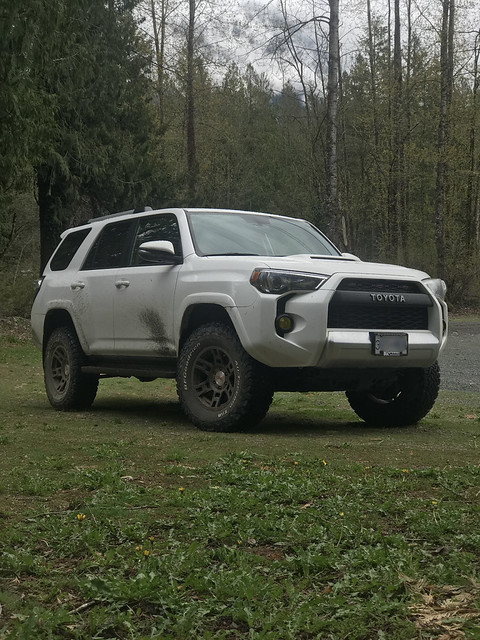

I put Dobinsons C59-300s on mine, at the lowest clip. This lifted the front a little over two inches, as far as i can tell. The ride is great, no complaints.
