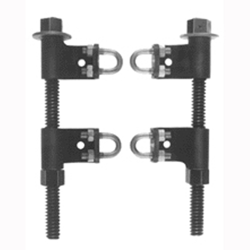

Well after hours of trying, the rental compressor wouldn't come out of the OME 880 running a 5100 on setting 3, or setting 2, or even setting 1.
What compressor works with a 10 coil, coil running a 5100?
Basically this style doesn't work on OME 880's. Once you compress it, you can't get the feet out.

I think you're doing it wrong. If I were you I'd stop and let a shop do it. I used this same exact style that I rented from O'Reilly's on my 880s about a month ago with no issues. I had 5100s on the second perch.

wish I had known this method at the time. used those two bar hook compressors and it was scaring the crap out of me the entire time
When I swapped out for '99 talls the coils were so tight I couldn't get the hooks to fit in..So all I did was back the bolt all the way out angle and slide the hooks in put the bolt back through the top and to the threads and cranked it down..worked fine! Also kept the top hat on with the nut tightened a couple turns and vise grips holding the spring to the base so it wouldn't twist on the lower perch or come flying off. And make sure you over compensate for the added length of the coil being taller that you don't run out of threads DECOMPRESSING it..yeah it is a little sketchy but after awhile I didn't hardly think about it because I did everything I possibly could to know it was safe. Good luck!

I used 3 compressors on the spring just because of paranoia. One tip for the threaded rod style compressors: to make it easier to remove a stuck "jaw" from between the coils you can remove the threaded rod then slide the "jaw" up or down the coil for a wide space to remove it.
