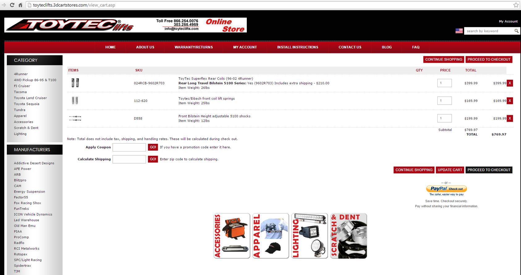

ultimately id probably recommend superflex and bilstein 5100s for the back, and the toytec eibach 620lb with the tundra bilstein 5100 for the front.
