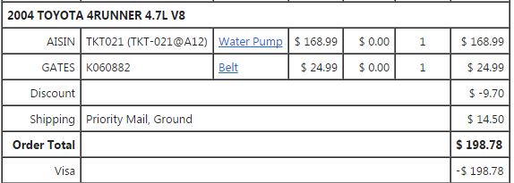

Assuming you have a v8 this is the Aisin kit I put on mine with a gates serp belt from rockauto.com. The kit comes with the timing belt, water pump, pullys, and gaskets you need. I bought a new thermostat and the coolant from the dealer. You also need rtv sealer for the water pump/thermostat joint.
There are a few step by step youtube vids and blackworks did a write up on here too to help you with what tools you need. Its a pretty big job, and if you mess up it could ruin the engine. :target:
Link to blackworks write up, just make sure to line up the timing marks the way yours are when you take it off. Not the way you see in the write up.
