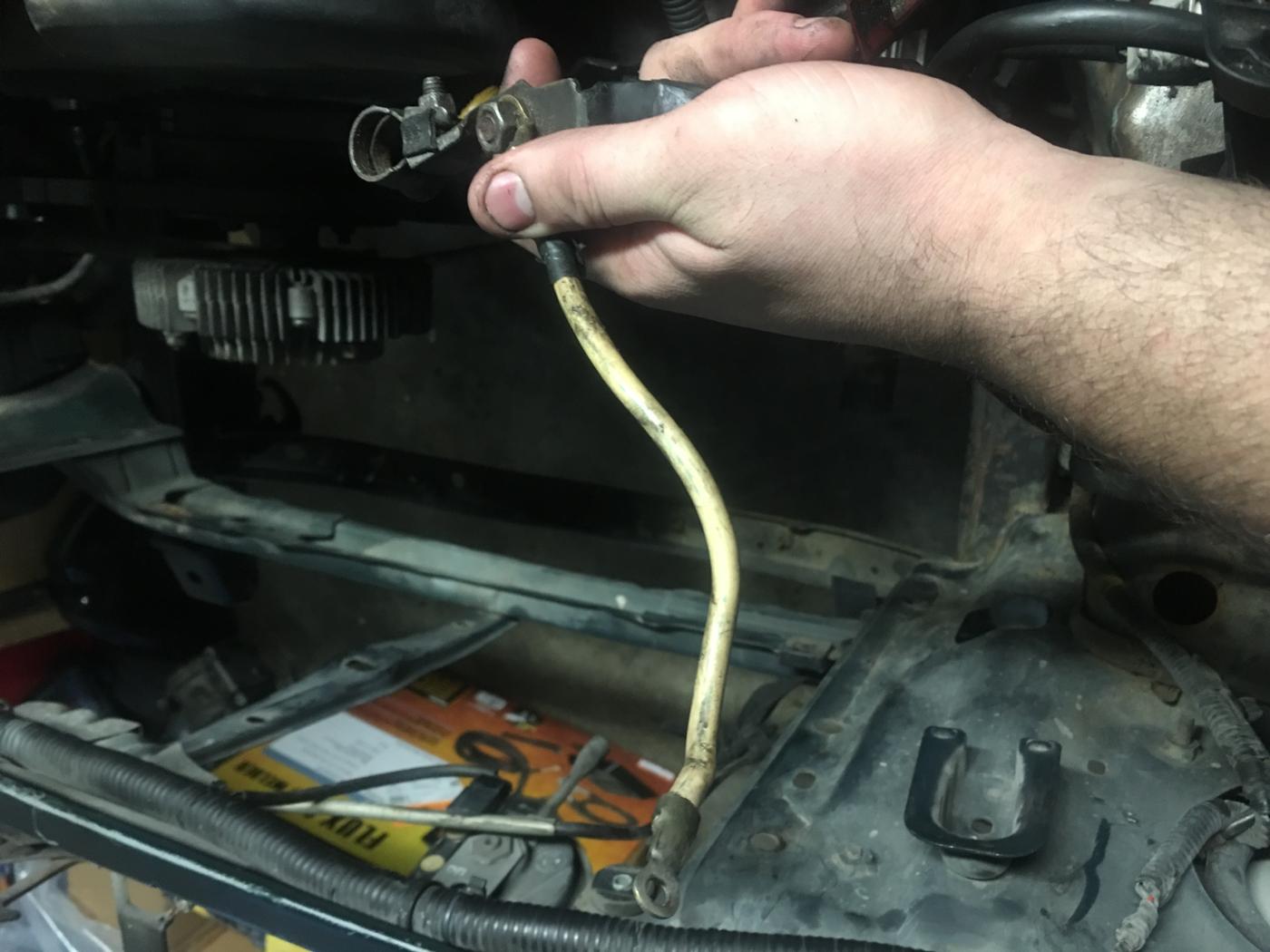

Having trouble remembering where it goes. I have a picture of it going into the fuse box but I don’t see where it could have attached. Maybe one of those two white 8mms?
Here is a picture.
inboard end of the fuse box. it snakes up through the end. shown here. (dont mind the blue, this picture was from a different mod. and the red wire next to the blue is also not a stock wire, that was aftermarket add-on)

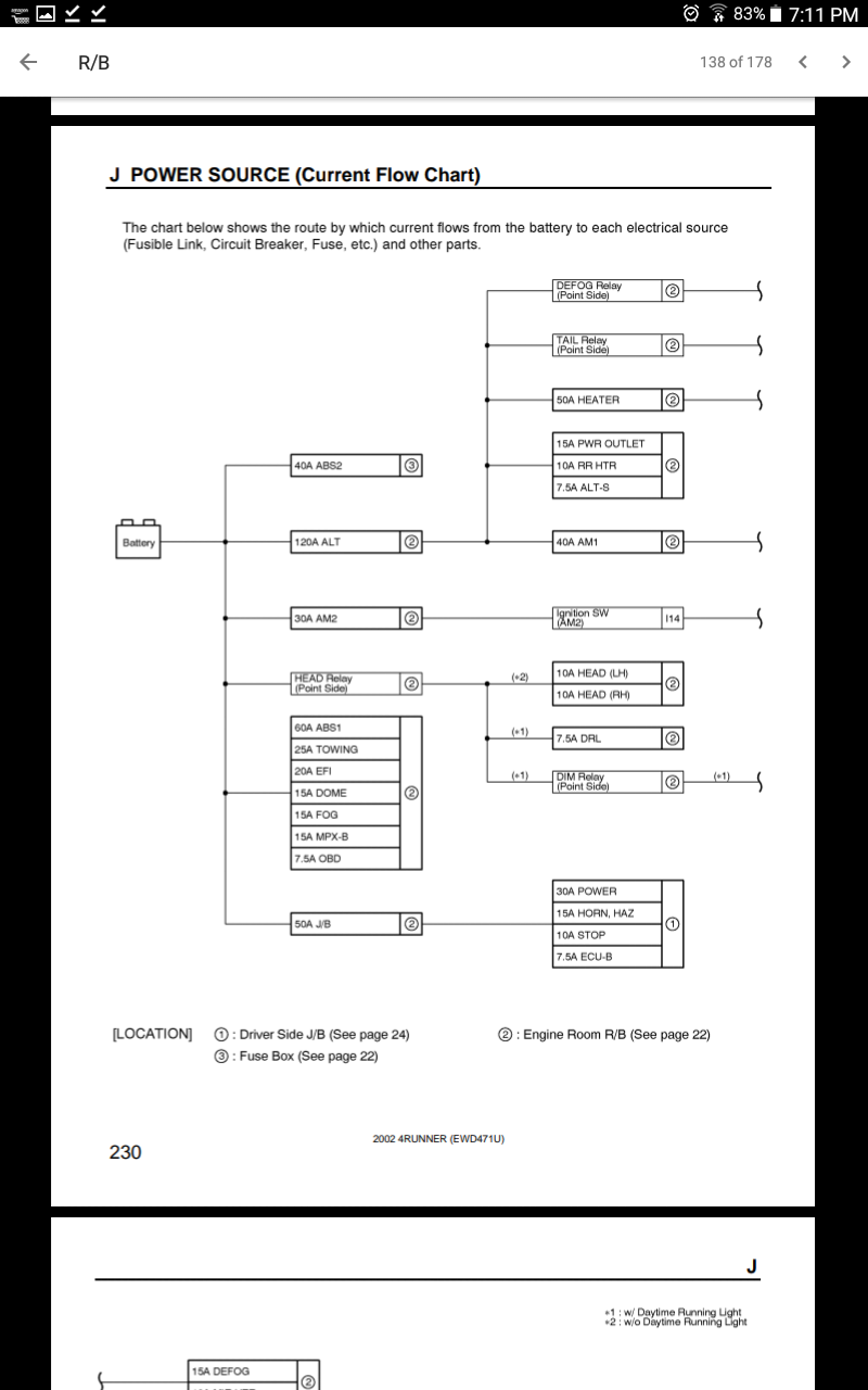

There should be a metal buss bar as a common point but the 120A link is how it show's in the wiring diagram. I have never done it so just going by what I think
