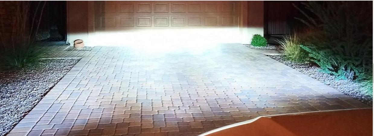

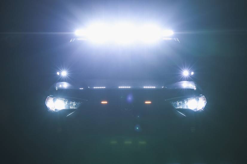

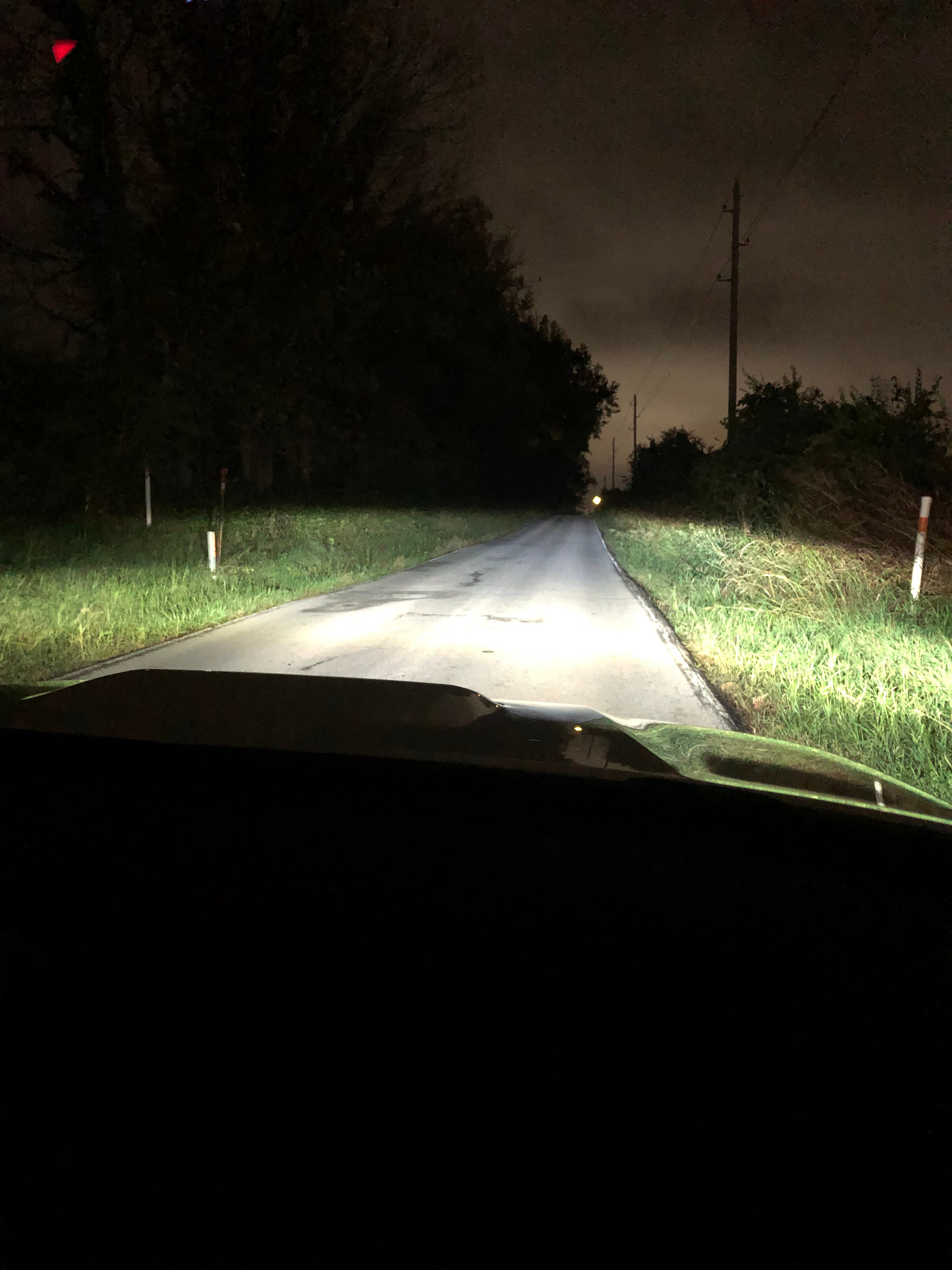

I've been running the 'OPT-7 HID Kit' since 2016. The price was good @$28 bucks; ...so reasonable, I bought two sets, just in case a bulb or Ballast goes out on the road one night!
I've 'NEVER' been flashed for blinding anyone with these H-11 low-beams... wish I could say that about the LED's I replaced with these, I have those living in my factory fogs now Lol!
Here's a photo (you can't judge the level of brightness from the pix):
2049da16-9471-4c19-8e23-11c0ea64cab2.jpg~original
They're three years old and I never had a lamp failure, color is 6000k: Ice-blue:
20160219_182120.jpg~original
These install in about 30 minutes; only because I was too lazy to remove the battery to make things a bit easier! there's a link (Below) to where I bought them:
