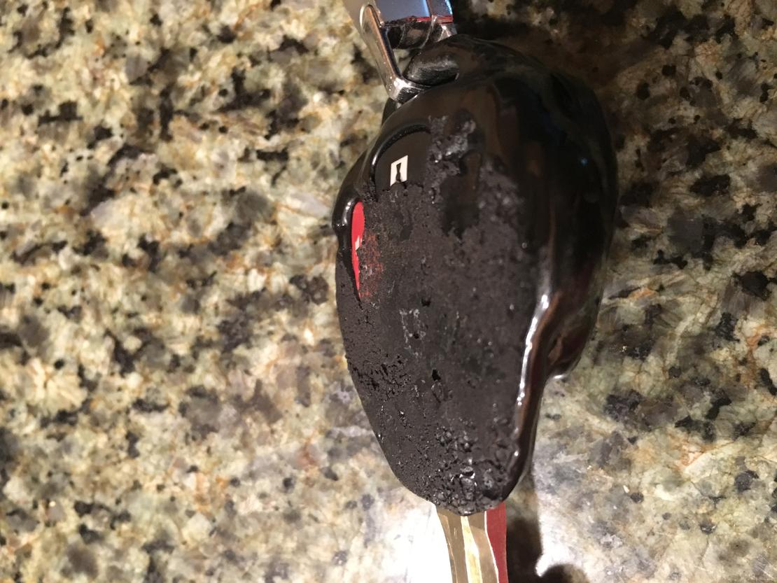

Side note* at least we know the 4runners are tough but the key not as much lol
The dogs pushed the key under the oven, got lodge in and melted the top. At least it's just a surface melt. Going just put the internals in a new shell and we should be alright.
There's a magnetic(?) chip in there that you need to get out as well. Without that the truck will crank but won't start. It just looks like a little gray rectangular thingy.

Originally I called the dealer and they said 300-350 for the key and programming. I just swapped the key blade, externals, and chip into a shell from eBay; saved a bunch of money instead.
